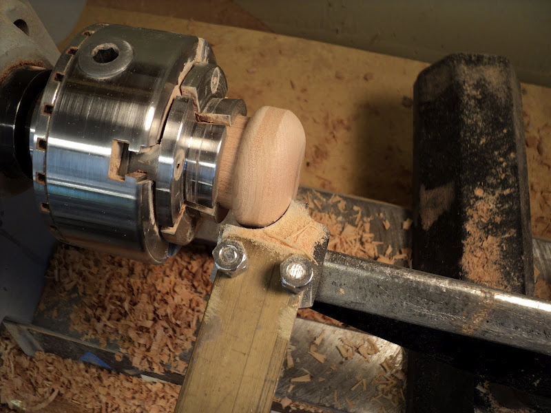

I read "somewhere" about making a cutter-less lathe chisel (or cutting the end off of an old one) and bolting a cutter from a set of 3 cutters for a molding head on the end of it (much like some of the carbide tipped chisels now available) to be able to turn repetitive profiles. Each set of cutters gave them a chisel and 2 replacements. They formed the mounting point so that just like on the molding head there was more than just the bolt holding the cutter in place.

Does this look familiar Francis?robinson46176 wrote:I read "somewhere" about making a cutter-less lathe chisel (or cutting the end off of an old one) and bolting a cutter from a set of 3 cutters for a molding head on the end of it (much like some of the carbide tipped chisels now available) to be able to turn repetitive profiles.
[ATTACH]16120[/ATTACH]
Sorry about the tiny photo, better onehere.
It's cutting the top finial for the leg of the cabinet in my avatar.
Paul M

A little bigger!;)
[ATTACH]16121[/ATTACH]
