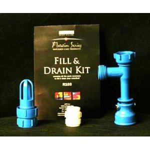

They make plastic ones for filling and draining water bed mattresses
[ATTACH]16327[/ATTACH]
waterbed fill & drain.jpg (16.04 KiB) Viewed 2319 times

It's called a siphon. I have a yellow plastic one. Works as explained above by Venturi effect. Same as a carburetor.

Normally called an eductor.
