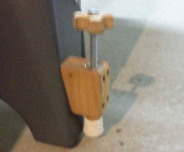

Eliminating the teeter
My SS lives in a 3 car garage with 3 drains. Needless the say, not a level flat floor to be found anywhere in my "Shop". I never had a problem with table alignments but more with the instability of the SS. My answer to this problem was the addition of leveling feet to the legs. As shown in the attached photo. It is a 1 1/2 inch by 3 inch hardwood block with threaded inserts and a 7 inch bolt with a rubber foot threaded through it. When I want to work, I position my SS where I need it screw down the foot or feet to provide a level stable saw.dusty wrote:I would venture a guess that most of us are not blessed with flat, level floors in our shops. A couple of us but not most of us.
Given that fact, I am wondering if anyone has trouble maintaining table alignments that can be directly attributed to the resulting instability brought about by one leg hanging free. My Mark V now teeters back and forth a bit on two diagonally opposing legs.
I just rearranged the shop and I now have that issue. There have been no alignment issues yet but they seem inevitable if I don't create some firm footing. I guess before I was just lucky and the four legs all rested firmly on the floor.
- SS Leveling Foot.jpg (94.67 KiB) Viewed 1754 times
That is neat!macgyver wrote:My SS lives in a 3 car garage with 3 drains. Needless the say, not a level flat floor to be found anywhere in my "Shop". I never had a problem with table alignments but more with the instability of the SS. My answer to this problem was the addition of leveling feet to the legs. As shown in the attached photo. It is a 1 1/2 inch by 3 inch hardwood block with threaded inserts and a 7 inch bolt with a rubber foot threaded through it. When I want to work, I position my SS where I need it screw down the foot or feet to provide a level stable saw.
