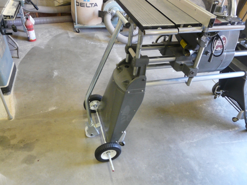

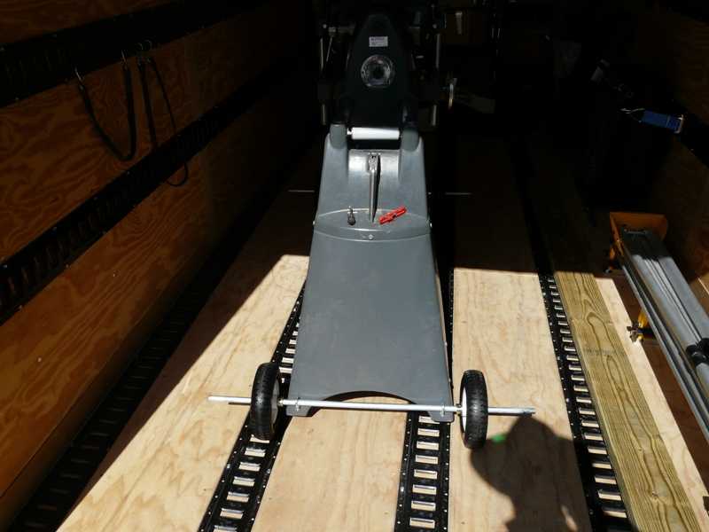

A while back I posted about a better way to move my 510 from the shop to the trailer to the job sight etc. I wanted a simple fix that would also work with my other Shopsmith. This is what I came up with.
[ATTACH]16745[/ATTACH]
[ATTACH]16746[/ATTACH]

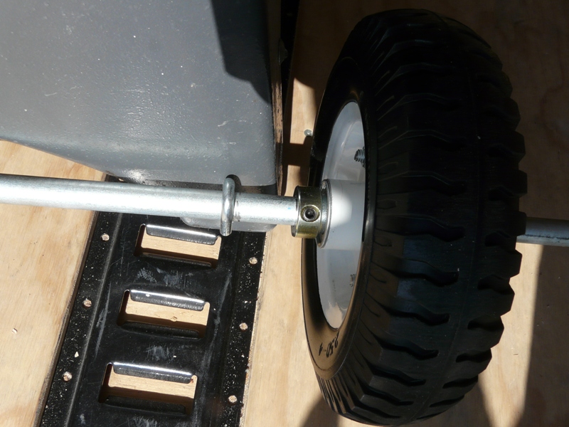

I made a simple axle from 5/8 round bar and attached wheels with stop collars. I mounted some small rope hooks onto the legs of the 510. By lifting the machine one end at a time the rope hooks just set over the axle. Very easy to set up and break down.
[ATTACH]16748[/ATTACH]

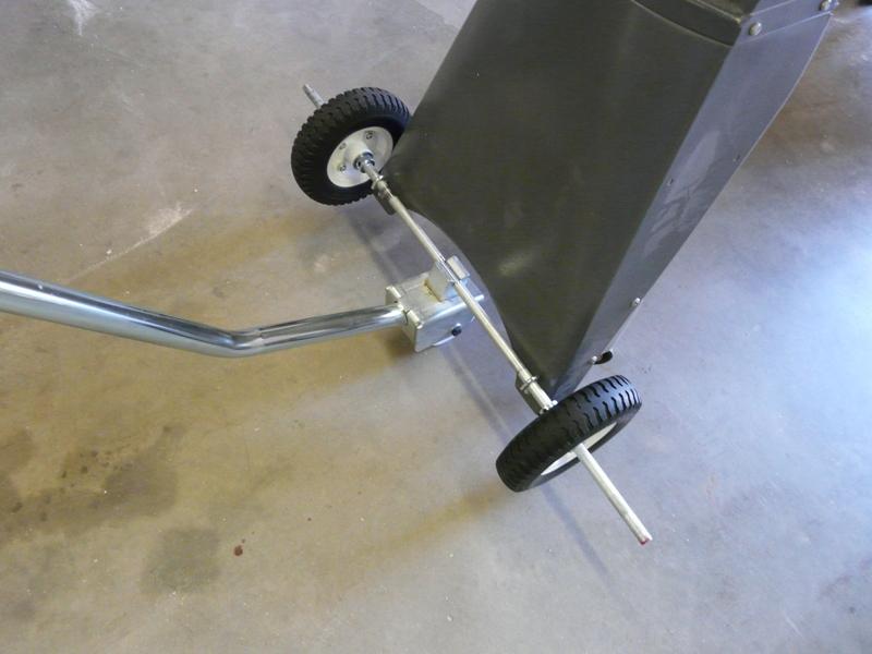

Now while the system worked pretty well by just manhandling the light end of the 510 I had a thought about using the moving handle that came with my Mini Max CU300 Smart.
[ATTACH]16749[/ATTACH]
It required a slight modification to one of the axles.
[ATTACH]16750[/ATTACH]
Now the handle just slips into the knotch.

[ATTACH]16751[/ATTACH]
And by lifting the handle it picks the front wheels up and I can make tight turns with ease.
