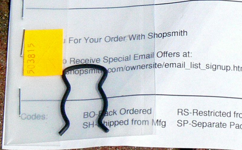

Caster Wire Clip 'Available'!
I fairness to both Shopsmith and Dave, I must update this thread.
Called recently to order another part and mentioned the clip.
Dave stated they are now available!!!
I ordered one and am now satisfied.
Albeit they are now quite pricey!
So perhaps some 'good' came of this thread?;)
[ATTACH]18294[/ATTACH]
- caster retention spring order.jpg (100.02 KiB) Viewed 688 times
