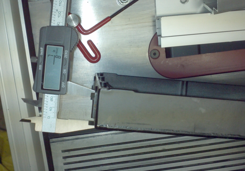

lightnin wrote:Yes it looks looks like something changed there are different upgrade kits.Something changed in 1986
In 1986 the 510 tables changed. The center hole(main table) was moved. The earlier tapped holes were replaced with drilled holes and kepnuts. It is the drilled holes(a bit sloppy fit) that allows vertical adjustment of the rails.
I think the bosses were changed also. Your pix may illustrate that. AIUI, the earlier version required drilling out the threads and possibly drilling a new hole.
Since you appear to have different rail versions, You will need to make sure the table versions are a match.
You may need to do some shimming.
The holes all look the same I can't notice any taper the holes.
The table in question and another are both 7/8" top of hole to top of table.
I guess that's a good thing.
[ATTACH]18559[/ATTACH]
I'll mess with it a little each night after work all week and read all of Dusty's precision alignment posts again.
If I strive for his precision I may end up with acceptable alignment.
I've seen his YouTube videos so I've heard his voice and tonight all the voices in my head sound like him.
