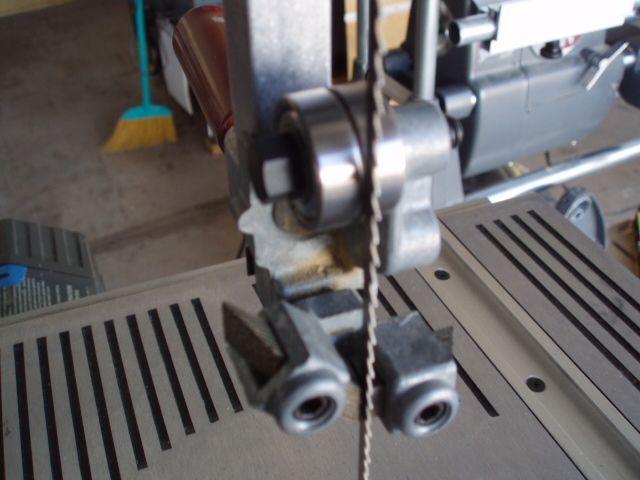

Anytime I see or hear that no changes has been done to the Shopsmith Bandsaw upper and lower roller bearing or bushing guides, I have to recommend switching to the a set of the auto track bearings and bolts for these upper and lower guides. With a little adjustment, the blade will track between the 2 bearings. Only one size bearing is needed for the bandsaw with this change. I use 6 higher quality 627 bearings in each bandsaw. Sometimes I use a very thin round shim from the roller bushing between the 2 bearings at all 3 locations.
[ATTACH]14774[/ATTACH]
This is the Carter Stablizer guide which is much higher priced.
[ATTACH]14775[/ATTACH]
I have been using this change for a few years on my bandsaws that I use and rebuild. Prior to this change, I have been machining a center "V" groove in the roller bushing for the upper and lower blade guides to make this modification work as a blade stablizer too.

Unless it's a trick of photographic lighting, there appears to be a very large gap between the angled block and the blade. If that is so it could account, by itself, for the rough cuts with both blades.bffulgham wrote:...
[ATTACH]14773[/ATTACH]
If those blocks are "Cool Blocks" (they appear to be to me) they can be adjusted right up against the blade (not forcefully).
A re-cut test may be in order (?).
Those are good photos imho. Close-ups like that really tell the story. I believe I'll try that with mine.
Thanks.
keakap wrote:Unless it's a trick of photographic lighting, there appears to be a very large gap between the angled block and the blade. If that is so it could account, by itself, for the rough cuts with both blades.
Thanks.
Good comment/question. I just did a quick check and I believe the gap is a photography optical delusion. I wish they were cool blocks, but they are the standard factory issue guide blocks. I did the standard trick of sticking a piece of scotch tape to both sides of the blade to do the spacing of the blocks. I'll try to do a closer examination tomorrow when I have some daylight...set the blade tension, and check the gap again.

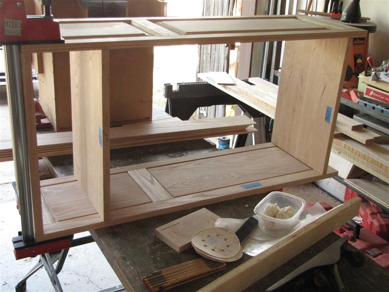

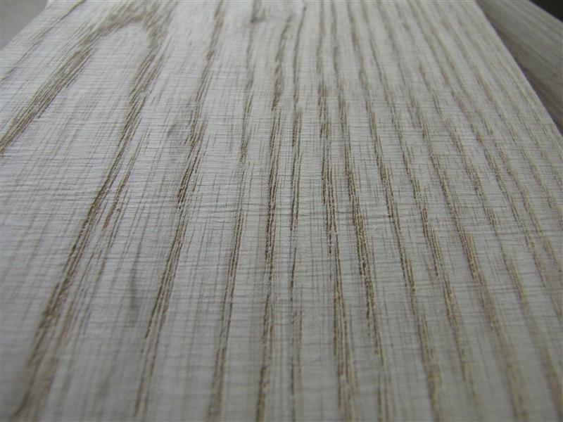

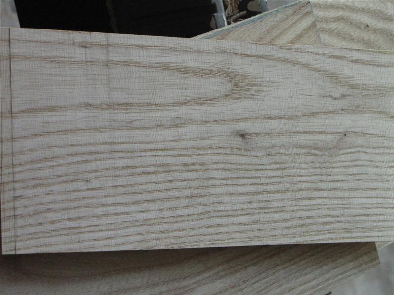

I'm building another bookcase project, this time out of white ash. I needed 5 slats for the back. The slats are approx 5" wide and 38" long. I ripped 3/4" material to width and used the bandsaw to resaw. One modification I made to the BS from when I started this thread was to get a set of Cool-Blocks. Set-up for the BS was done following the tensioning directions from Highland Woodworking.....
I moved the blocks away from the blade and raised the guard to about 5" above the table.
Set the initial tension using the scale for a 3/8 blade.
Powered up the BS and adjusted the tension until there was no flutter. (I forgot to check to see what the scale read)
I adjusted the Cool-Blocks so that they just kissed the blade, and made sure there was no binding at the weld by rotating the blade by hand.
Buttoned up the cover and cut a test piece to check for drift.
I did have about the same amount of drift with the WoodSlicer that I experienced earlier. So, I set the fence to match the drift and cut a test piece. I got, IMHO, a really good result. I got a much smoother cut than I first experienced.....I'll have to give the credit to the Cool-Blocks for that. One pass thru my lunchbox planer removing about 1/64" and I was good to go.
Bookcase:
[ATTACH]18554[/ATTACH]
Test cut Macro shot:
[ATTACH]18555[/ATTACH]
Test cut a little further back:
[ATTACH]18556[/ATTACH]

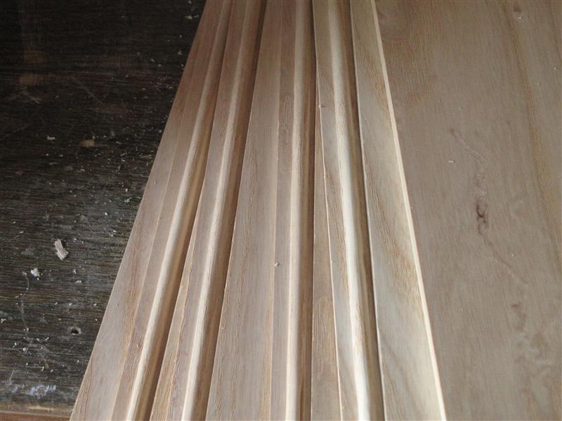

Stack of slats:
[ATTACH]18557[/ATTACH]
Bookcase:
Stack of slats:
