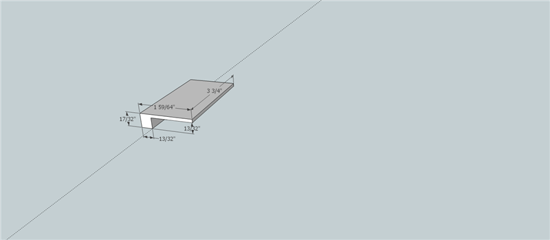

They really are not a necessity. The objective, when using them, is to get all rails set at the same position relative to the top of the table. Any spacer that does that works as well as does the official gauge. My gauge sets the rail .406" below the table surface. Remember, the dimension is not critical. It is, however, important that the rail displacements at all points be the same dimension.
Table Rail Gauge (Custom).png (25.34 KiB) Viewed 735 times
