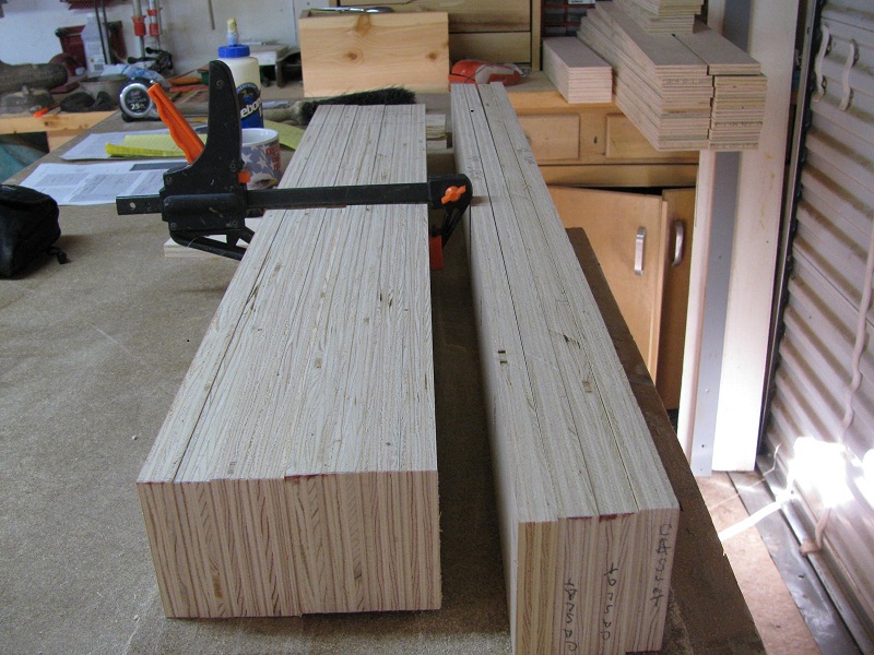

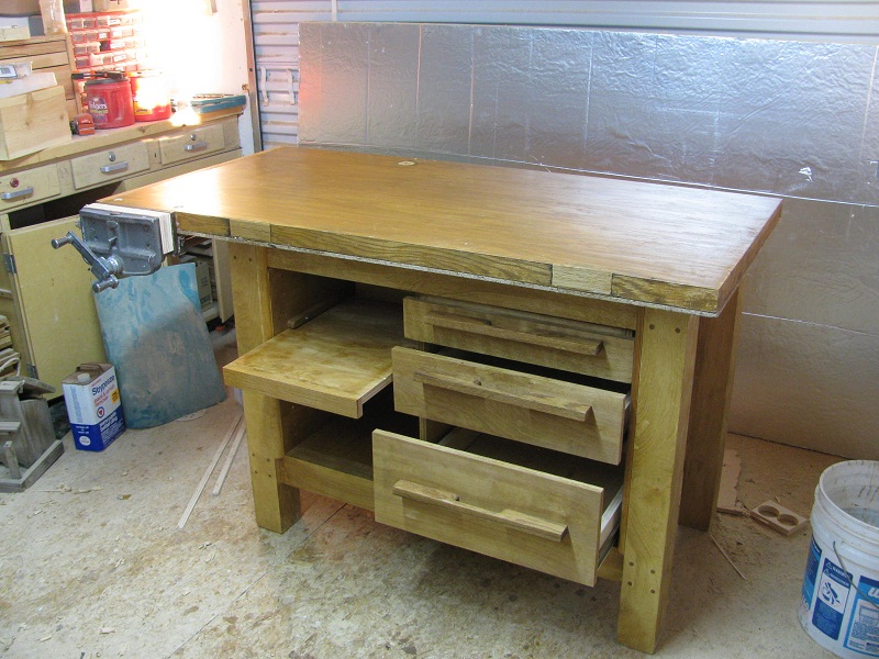

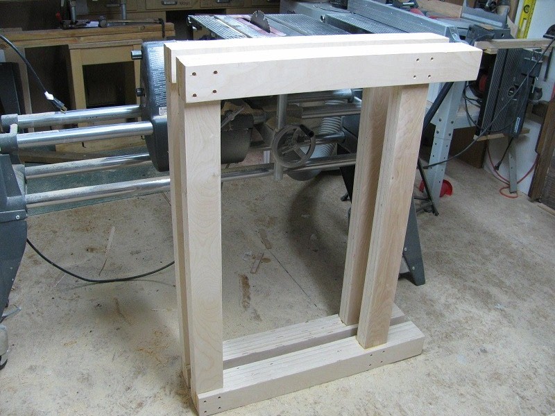

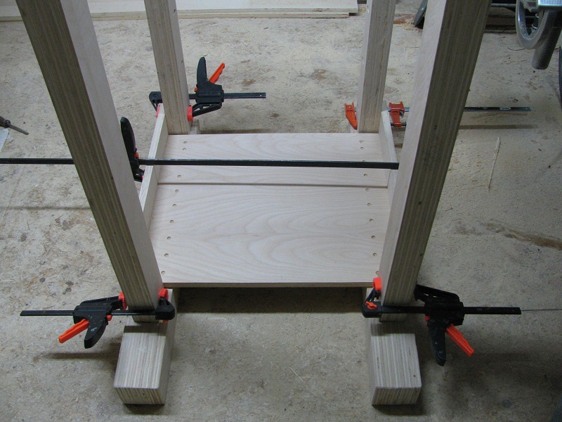

Here are some pictures of the assembly portion of the bench and the mostly completed project. The top is a recycled solid core door and the vise is recycled from an old school shop. It is an 8 in Columbian. #1 is just the cut slats for all the legs and stretchers, #2 is a shot of the assembly jig for the stretchers, ( this was the one I was concerned about as far as glue time), # 3 is the front and back frame assemblies, #4 is the instalation of the end panels, and the last is of the bench with drawers installed.
Dave

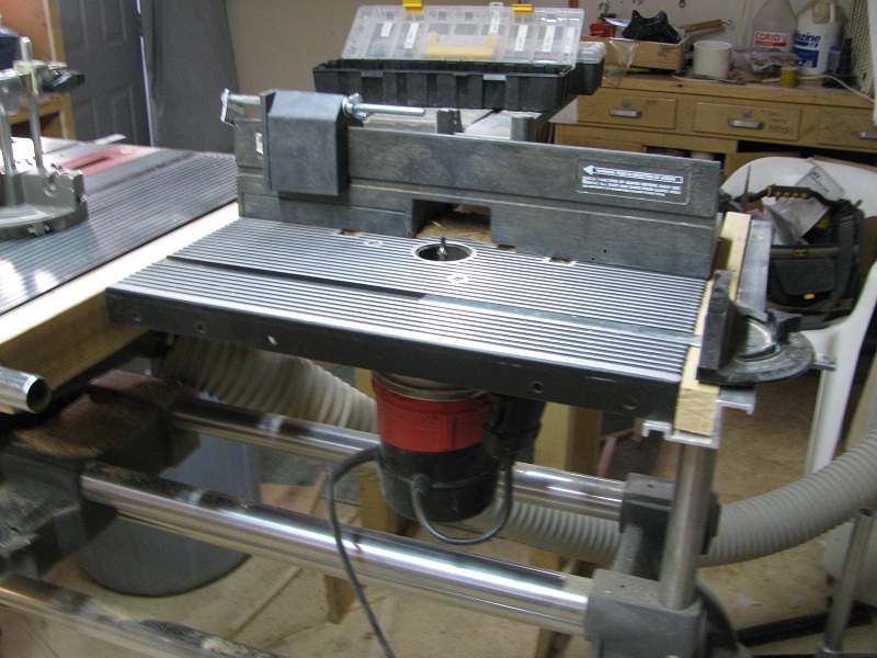

Another project that I finished was this attempt at getting a router onto the MV. I am to cheap to by a new router and table, so I tried using my old Sears router and table and mounted it between the main table and a auxillary table from an old Mark 2. Not real pretty, but it works and saves a bunch of space. I hang it on the miter saw frame when not on use.
router table experiment.JPG (183.94 KiB) Viewed 1991 times
Dave
