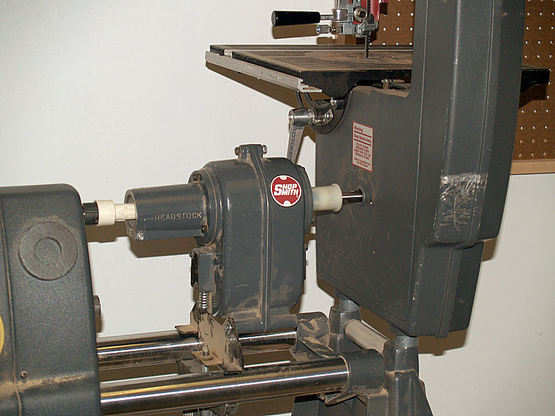

Can the speed reducer be mounted on the left side of the power head the side opposite the sliding quell??

Yes:
[ATTACH]19984[/ATTACH]
I saved this from another post but no recollection from who. Maybe the search function might find it. I seem to recall Nick Engler explained how.
EDIT: when all else fails.....check the Owners Manual: pg18/19 in Speed Reducer Manual shows how. You swap the drive hub and the white plastic female connector(called a "special coupler") on the speed reducer.
