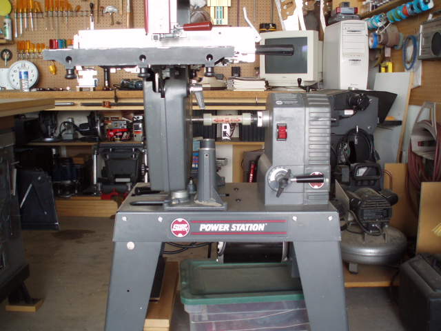

With the Power Station, when being used to power standard SPT (bandsaw and jointer, etc), the Main Drive Shaft is on the left side of the transmission box. The switch is on the transmission box right in front of the operator slightly to the operator's right.
[ATTACH]20489[/ATTACH]
This is not a particularly handy location. For example, when using the bandsaw, you have to reach around and to the rear of the bandsaw table.
The 2nd power switch on the Crafter's Station is on the other side of the transmission; placing it under the main table and about as hard to reach as the Mark V switch is with a floating table to the left side.
Power Station (Front).JPG (162.67 KiB) Viewed 1953 times

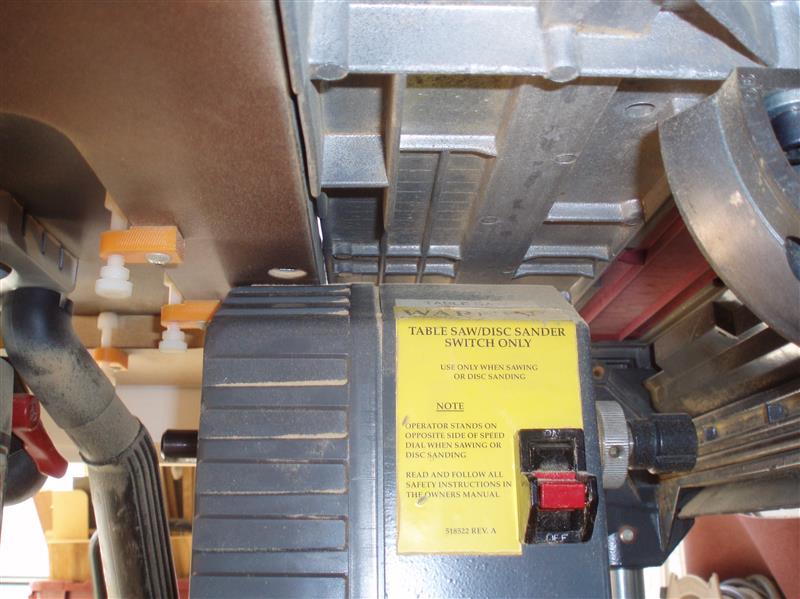

Here are a couple shots of the Crafter's Station for enlightenment.
[ATTACH]20498[/ATTACH]
[ATTACH]20499[/ATTACH]
crafters station 002 (Custom).JPG (74.75 KiB) Viewed 1986 times
crafters station 006 (Custom).JPG (53.18 KiB) Viewed 1987 times
