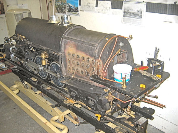

A friend was building a model steam locomotive and found a hospital bed mechanism to build it on. The engine weighed nearly 1000 lb. but he could crank it up and down:
[ATTACH]21205[/ATTACH]
You could crank your Shopsmith to whatever level is comfortable!
- IMG_1505 Hudson 17Aug06.JPG (82.57 KiB) Viewed 2237 times
