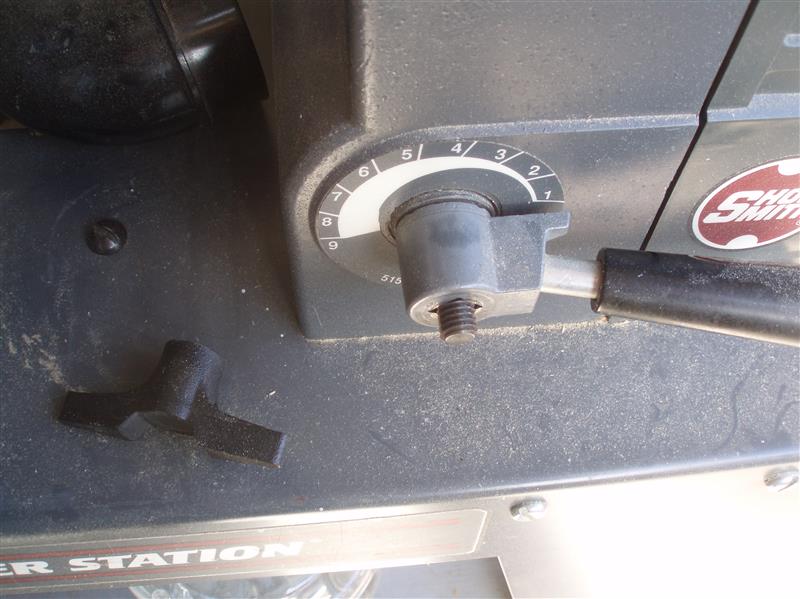

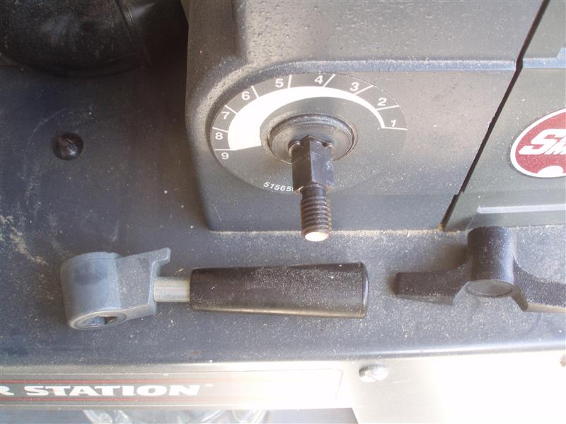

I just came home with a SS Bandsaw that was attached to a Power Station. I appears to be in very good condition and runs well but the speed control lever on the Power Station seems to be missing something. It will not lock the speed and as the unit runs the speed lever moves around on it's own. I don't have a manual for it or a parts diagram. It would seem there is a washer or spacer missing from behind the lever. Any body have a power station they can snap a photo of or a parts diagram?
It might be more fruitful if you posted a picture of what you have.
BUT...never fear. We can resolve this issue.
[ATTACH]23989[/ATTACH]
[ATTACH]23990[/ATTACH]
It is a friction lock.

Looks like the shaft is much farther out, it moves in and out at least a 1/4".
triumph_tech wrote:Looks like the shaft is much farther out, it moves in and out at least a 1/4".
In your posted image, you can see a "c" clip that prevents the shaft from going into the Power Station Casting. There should be one similar, if not identical" on the inside of the casting on that square shaft. I suspect that clip is missing. If there it would prevent the shaft from coming outward.

Didn't find a c-clip but did find allen screw and washer that was backed out almost 1/2" on the other end of the same shaft. A drop of loctite and a 5/32 allen wrench and I'm back in business. Thanks! Not too bad , a power station and a bandsaw for $100.

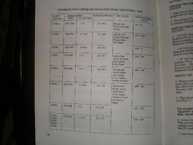

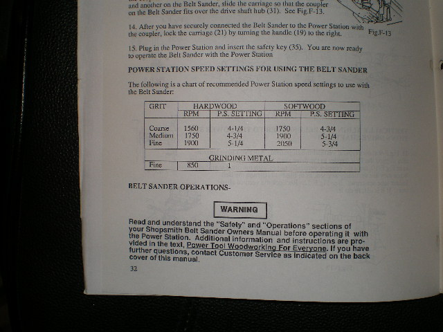

Is there a speed chart for the Power Station? I know it doesn't run as fast as the the MkV does but how do I know what speed for what tool? Other than the planer are there other tools that don't work well with the Power Station?
judaspre1982
Posts: 1237
power station speed settings
Post by judaspre1982 »
power station speed settings 001.jpg (122.44 KiB) Viewed 2393 times
power station speed settings 002.jpg (126.42 KiB) Viewed 2386 times
power station speed settings 003.jpg (123.94 KiB) Viewed 2386 times
power station speed settings 004.jpg (136.2 KiB) Viewed 2390 times
power station speed settings 005.jpg (127.3 KiB) Viewed 2384 times

judaspre1982
Posts: 1237
more
power station speed settings 006.jpg (128.35 KiB) Viewed 2379 times
power station speed settings 007.jpg (133.15 KiB) Viewed 2376 times
