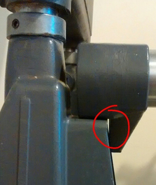

I put my proper bench build (vs. previous salvaged desk thing) on hold when I got the two ss off craigslist. However, I approximated what you suggest. My goal currently is to get the four tubes all parallel to each other...
With the way tubes off and the base on the floor upside down, I first shimmed the RH side of the base so the lower tubes were level, checking across the two tubes but ignoring the length of the tubes. I then played around until the other end was level across the tubes and the tubes had 48 1/4 inches exposed. I tightened down and flipped it back over, and wow! I knew the floor was off but didn't realize how much. I've shimmed the base on the floor and checked it all again and it seems good to go, though I expect to repeat the process with more care after I've got it all running right. I know it will still flex if not shimmed on the floor just right but it is a start.
Edit: forgot to mention: I looked around for something to use as temporary shims and came up with using a set of hex wrenches. They varied in size in small enough amounts over the right range so I was able to level the upside down bases, hex wrenches between base and floor.
So, now to go replace the way tube assembly - that poor roll pin! I've got to pick up some replacements.

Yeah, that is my plan at least. I have the lower tubes in a plane, to twist/wind that I can tell (very loose tolerances thought).
Now, I'm wondering again about the length of the lower tubes. Should there be any space between the tie bar and the left base when it is clamped? With the lower tubes set up as described above (just to the edge of the casting, which matches 48 1/4 inches exposed) and the tie bar clamp engaged I've got a tad over 1/16 inch space between the downward "V" portion of the tie bar and the base itself:
[ATTACH]25058[/ATTACH]
Should the tie bar brace against the base or is this space OK? It seems to me there should be just enough clearance that you can lower the way tubes down and then have the space close when clamped.

The clamp should firmly hold the tiebar in position without having to touch the casting. It should be adjusted to lock down firmly, but not require a gorilla to clamp.
