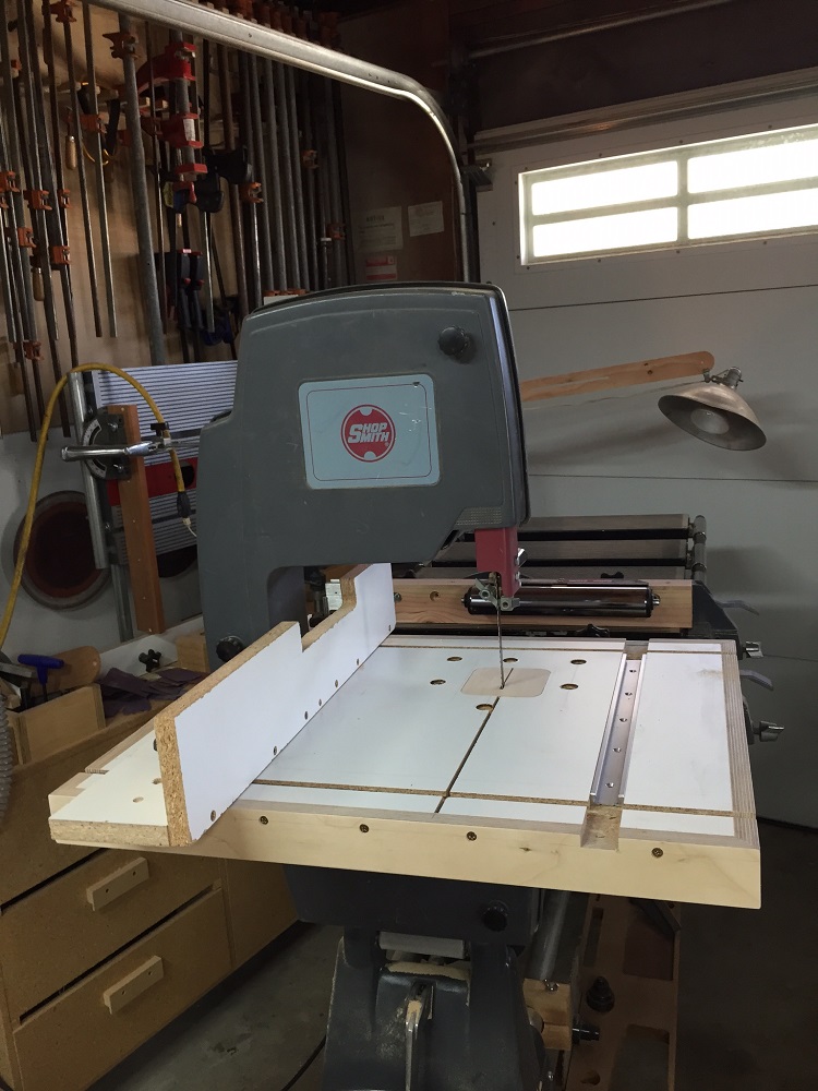

I found the table on the band saw is not really adequate for my needs. Its too small and doesn't offer enough versatility in jigging and clamping. This is my solution. Works really well and is rock stable for resawing.
Paul

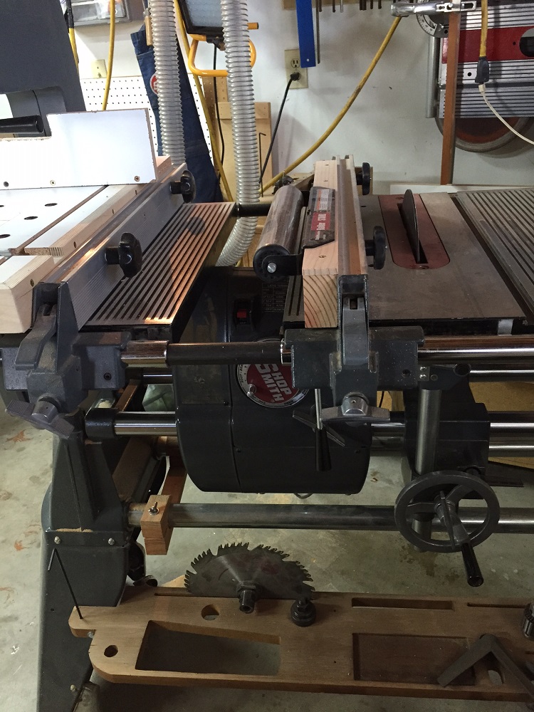

Re: Bandsaw Table - How to enlarge?
Here is a thread that shows how I expand the table size on my bandsaw.
http://www.shopsmith.com/ss_forum/viewtopic.php?t=13405
If you have a shopsmith with the ability to do so you can create a pretty big work area with out much effort.
