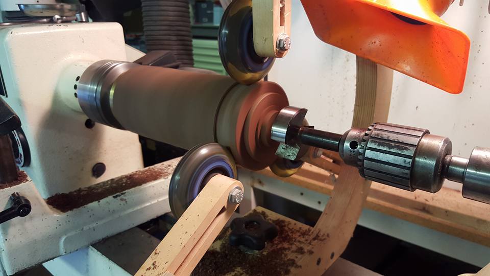

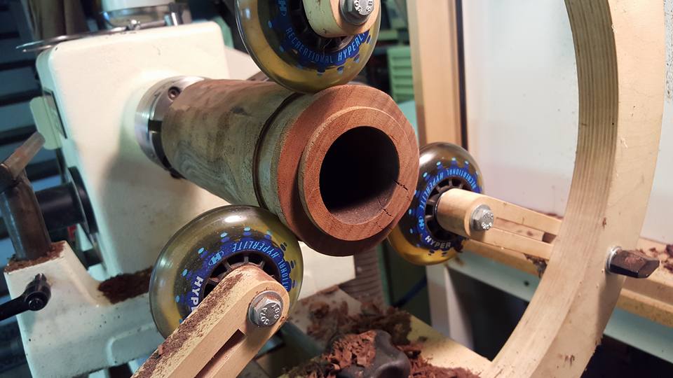

These are some pictures of a boring guide he built.

The above photo is called a steady rest. Used to keep spindles or bowls "steady" as you hollow (or drill) them out. Many on the market for $300 and up. A home made one does the job for a lot less. I mainly turn wood, so this has been on my wish list for a while.

The wheels are from a set of roller blades.
Re: Master Maker
Or possibly scooter wheels, Lee Valley sells them for that purpose. Polyurethane WheelsSteamdragon wrote:The wheels are from a set of roller blades.
I should imagine they would also be available from you local bike shop.

Some of you might remember the show he had on PBS years ago called Woodworks. He built a steady rest that is almost identical to the one above.
