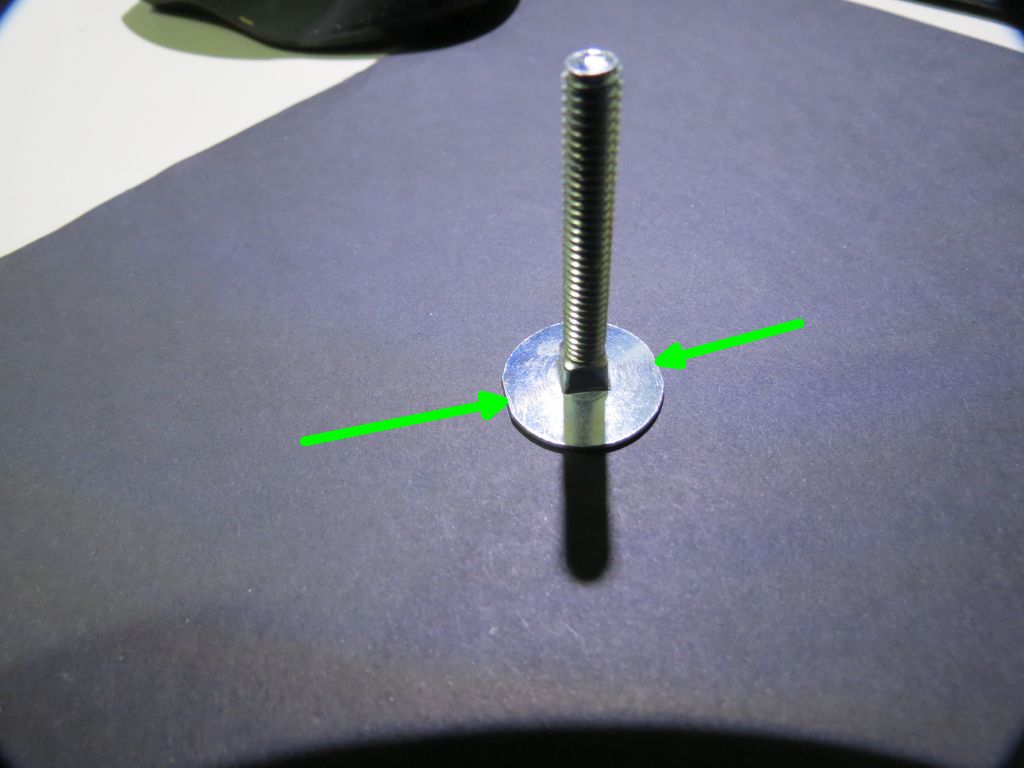

rpd wrote:Lee Valley has the 1/4-20 1" T-bolts, box of 10 $3,20 US. 1/4-20 T-Bolts and T-Slot Nuts
Have you used these in the SS fence/table before?
Sadly none of my equipment is new enough to have t slots in the fences, so no personal experience.
T-slot extrusions are pretty much standardized and the OP said he had used 1/4 20 bolts.
The heads on the 1/4 20 T-bolts measure .720x.508x.095.
If a wider head is desired there are 5/16 18 T-bolts, they measure .832x.508x.095.

Re: Shopmade T-bolt assembly
The elevator bolts do work. I have done it and my first try was done with a metal nibbler and while it worked it looked messy. You sure don't have to take off much to get the ones from Lee Valley to work. My second try I just used a file and give it 20 stokes on each side. I think 15 would have been enough.

I use toilet bolts. They're cheap and the brass ones are easy to cut to any length.
