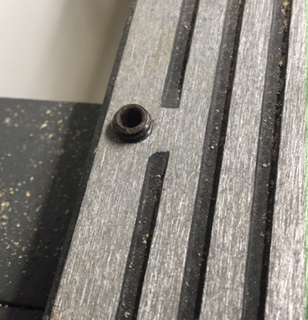

So, I have figured out with your help, where I went wrong with the Kreg bandsaw fence. Now, a question... WTF is this set screw for? It's definitely in my way! :o It is on the far left of the bandsaw table.

It is the screw that provides a stop when the blade is 90 deg to the table. But you have to set it. It may be too long and if it is use a shorter one.

ChrisNeilan wrote:So, I have figured out with your help, where I went wrong with the Kreg bandsaw fence. Now, a question... WTF is this set screw for? It's definitely in my way! :o It is on the far left of the bandsaw table.
It is the stop screw that sets the table back to 90* after you have tilted it. It has a lock nut on the under side. When properly adjusted it sets the table to be 90* to the left and right of the blade. The lock nut keeps it from moving. That set screw will be below the table when properly adjusted.

Well, thank you! I bought this bandsaw on Ebay and thought i had worked the bugs out. This should be the last one. I usually use a squre to be sure i'm at 90 degrees. Don't trust them screws! :)
