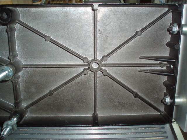

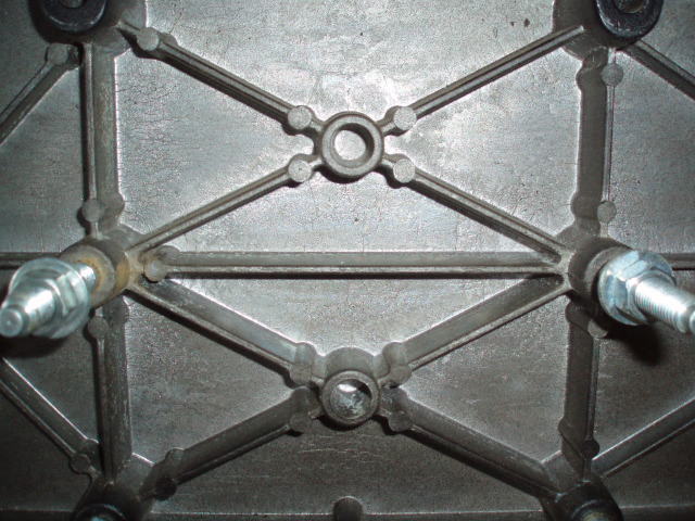

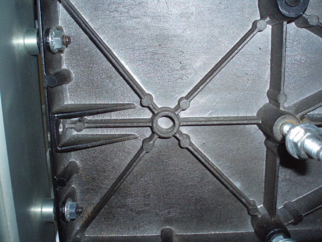

PS I took these shots of the table underside to confirm hole location. Are the circular reinforced areas in photos 1 and 2 where the holes are located?
The third photo shows two other reinforced areas. Does anyone know of holes being located in these areas?

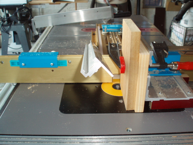

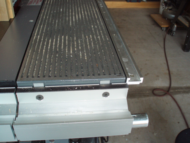

I attached a T-Track to a piece of 1" aluminum angle that is 22 1/4" long. The aluminum angle is then attached to the side of a table using three machine screws.
[ATTACH]2032[/ATTACH]
The band saw fence was removed before it fell off.

The 3/8" holes are drilled in the circles closest to the rails the TS fence attaches too, they are drilled from the under side of the table and I used a counter sink by hand to gently debur the top of the holes.
The mounting platform is held in place with the 1/4" 20 threaded rod with knobs (Ace Hardware), the standard 1/4" nuts are inserted into the casting circles on the bottom and pulled into place with a 1/4" bolt that is over several large and thick washers (fender washers) on the table top and gently tighten until the nuts seat all of the way into the casting circles. It's a force fit so go easy, once the nuts are seated into the underside of the table they will stay. The fender washers will also be used when mounting the jig.
The mounting platform is 23/32" thick (.718), you may have to adjust this measurement for your INCRA jig also you may be able to adjust the fence height on the positioner rail and just use a piece of 3/4" plywood
Jim in Tucson
Thanks, Jim. I did not have expect 3/8" holes; I'll have to redrill.
To avoid tear out on the table side when the bit breaks through, I will sneak up on final holes size. Of course there will be a backer board too.
