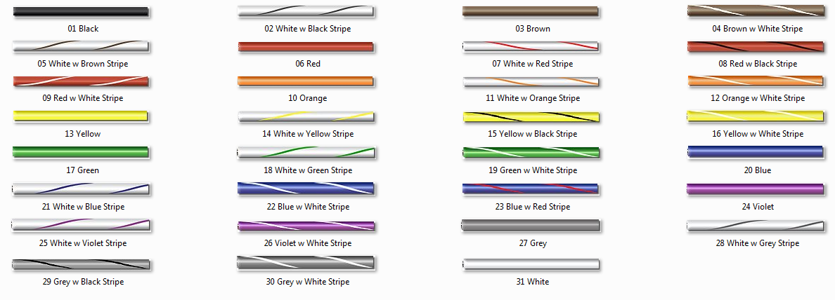

I have access to Visio, but have been unable to get it to draw colored wiring with the tracer, though some folks who customize it indicate that I can configure it to. I beg to differ, as despite how hard 'I' have tried, 'I' have been unable to configure it to and was hoping someone else knew how that could explain the process.
That's the element of a drawing program I want to find or configure. I have use for that functionality in areas beyond Shopsmith wiring.
I have need to draw wiring diagrams with most of the color/tracer combinations in the Sample I listed. I continue working on that issue in Visio 2013.
Everett
Some Sample Wire Colors with Tracers.png (131.11 KiB) Viewed 5099 times

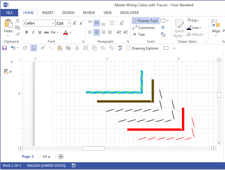

I really guess I should clarify my Visio issues after some have emailed me links for ground I have already plowed.
I can get multi colored striped lines in Visio as evidenced in the attached screen shot.
I cannot achieve auto scaling as the line widths change, requiring meticulous editing of point sizes in each selection, wire by wire, color by color, trace by trace. ie: 18 gauge and 10 gauge wire should visually be different in size to viewer.
I cannot achieve rounded corners in wires, even though selected. I can in other drawings that do not use the trace wire form.
I am disenchanted by the color separation on brown and black tracer on white wires... visually indistinguishable.
It's not that it won't work, it is that it won't yet work to my satisfaction and I have a great deal of work to do, outside Shopsmith wiring with wiring diagrams that involve many wire colors and tracers.
Everett
Sample of Visio work on Wire Colors.png (38.25 KiB) Viewed 5086 times

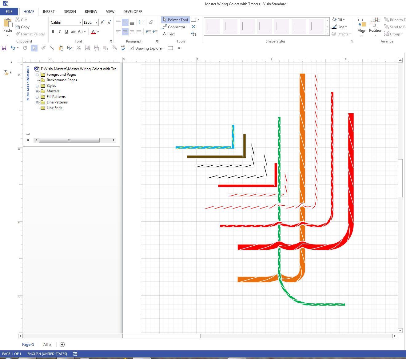

Been working on it off and on for months. Today I had a break through...
Now I just have to create them all, and convert them to templates....
Everett
A Bit of Progress on Wire Colors.png (147.63 KiB) Viewed 5071 times
