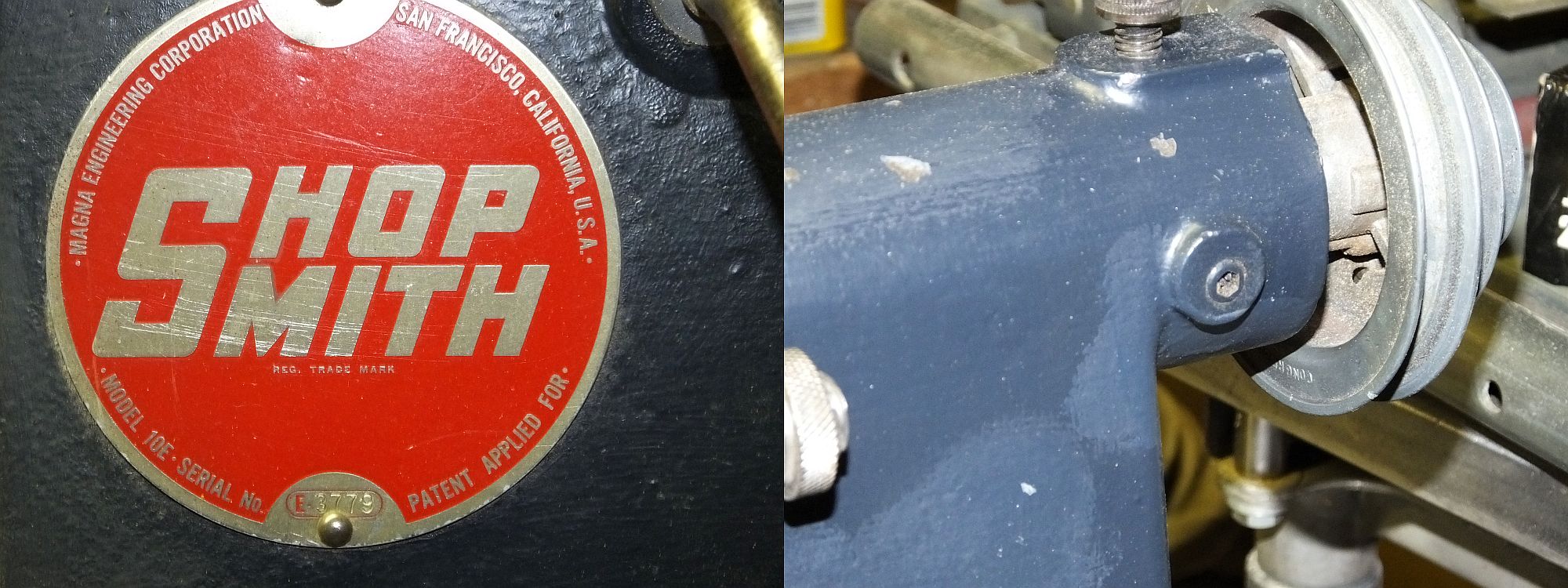

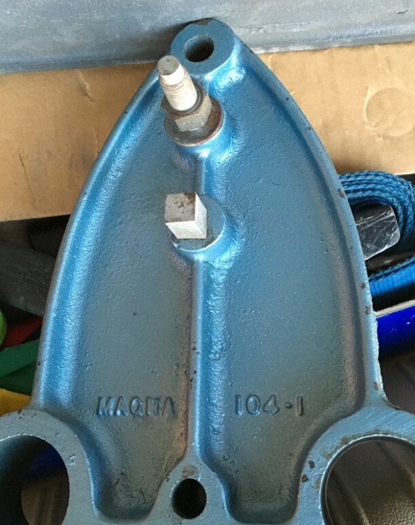

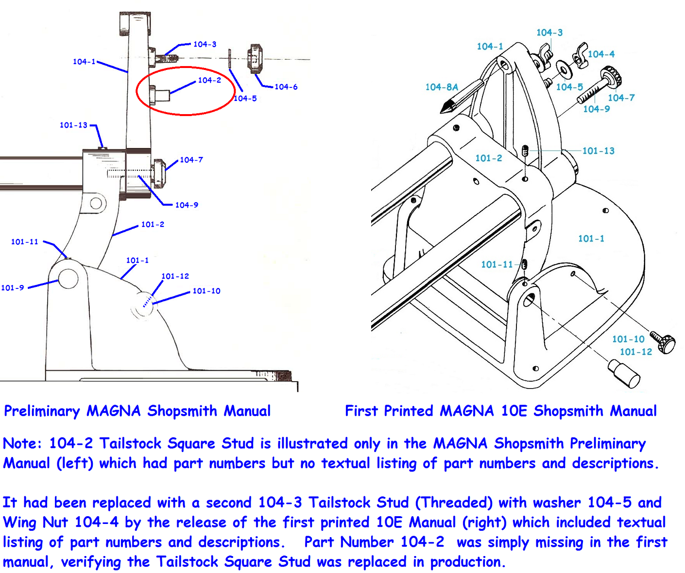

Another curious production change that I noticed occurred between the release of the Preliminary Manual (which I am in the process of restoring now) and the first 10E Owner's Guide they promised to release soon, within it.
The 10E's had a User Supplied Plywood Extension Table and a "Y" Mounting base for it.
Among the earliest MAGNA Shopsmiths produced were different than those soon after which had a production change occur even before the first Owner's Guide was released.
It was a change where part number 104-2 Tailstock Square Stud, was changed adding a 2nd threaded stud, washer and wing-nut just like the one above, and the knob 104-6 was replaced with a wing-nut.
Refer to the two part illustrations below.
I do know that it was still present on my 10E sn 1414 as illustrated.
I wonder how many 10E's produced after 1414 still had the Square Stud, and at what point it changed.

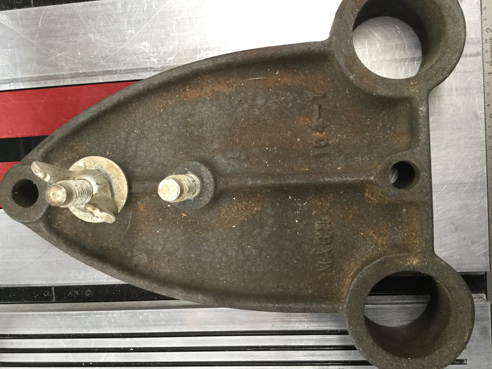

Re: A question for you Other early vintage 10E Owners

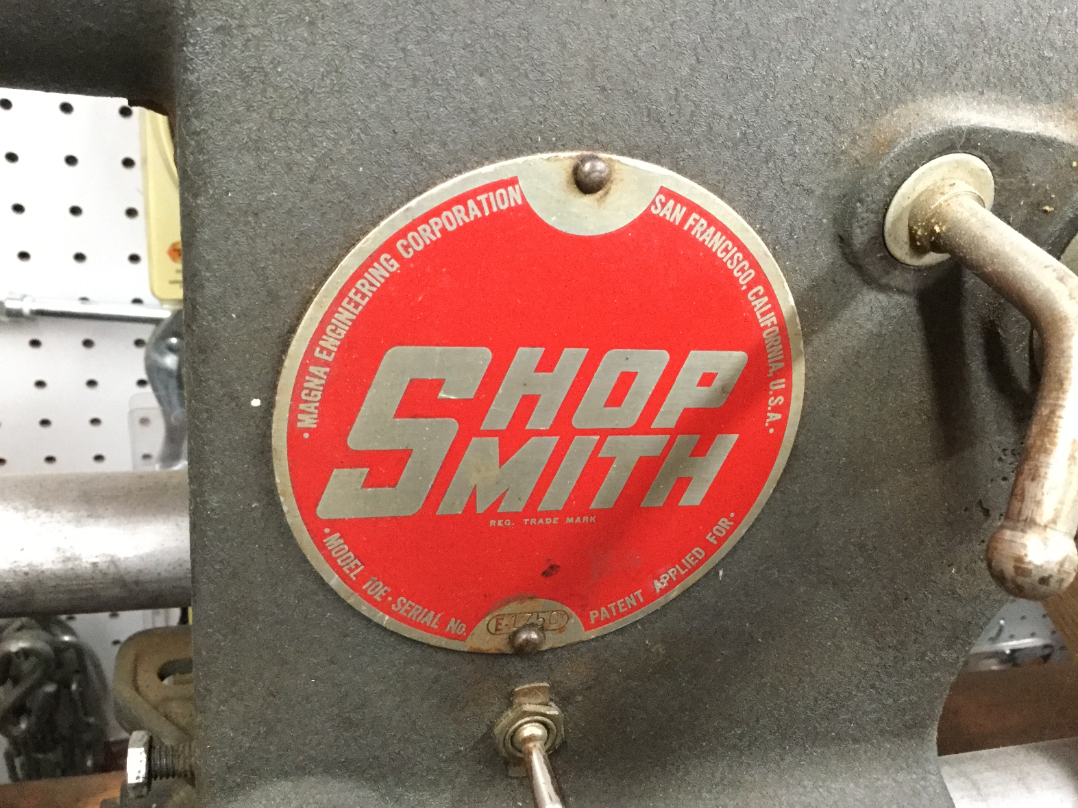

My #6834 has the plywood base and two round studs.
SN 3779 has two studs and wingnuts and plywood aux table.

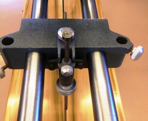

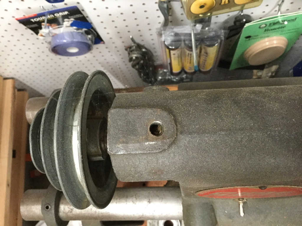

SN E-1750 has only one "nubbin" on the headstock. It came to me with an upgrade 10ER tailstock and aux table installed, but the originals were still in the goody box. Two threaded studs and a wingnut on this one.
In other news, while checking on these parts, I discovered that the goody box also contained a "very rare 10E original table raiser". It was disassembled, and I had no idea what the parts were for until I recalled and found that post. Thanks, guys! Not bad for a $140 machine that also included a speed changer!

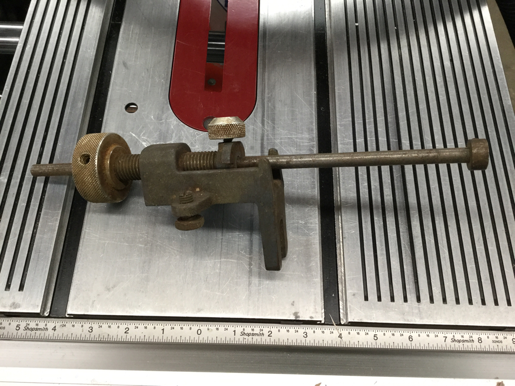

I have only seen maybe three. The one I have Buckeye's and maybe one other on eBay. They all had the straight sided main body casting. Has anyone seen the angled body casting pictured in the manual?everettdavis wrote:It is hard to find. I have seen only a handful.
