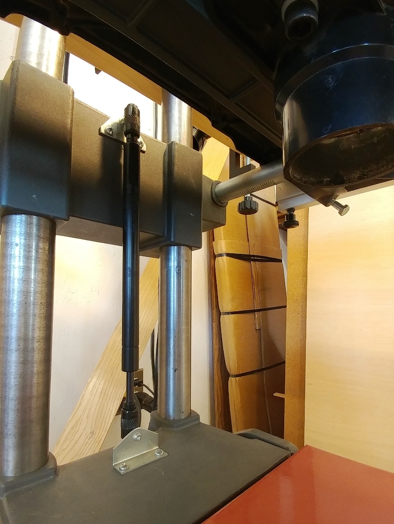

When you said Power Pro I was thinking of the lift assist that has the stronger cylinder not the table raiser.
Anyhow here is the picture. Mine is mounted slightly different because on my dedicated drill press the head stock and carriage are mounted on the way tubes 180° opposite of normal. The upper bracket is mounted on the carriage the same way. The lower bracket is a bit different but the screws are in the same surface of the pivot arm as the normal mount so there should be no problem.
If you take my lower bracket and turn it 180° in both directions and hang it over the edge of the pivot arm that would be the normal mounting position. The screws end up on the same surface as the way mine is mounted.
Confused yet? :eek:
The bottom line is that you should be able to install it just fine in the vertical position.
Confused yet? :eek:
Great! Thank you.
It is on order. No mention of back order so I should get it in short order.
