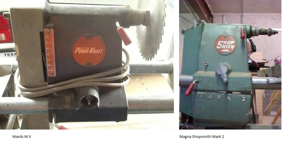

JPG wrote:What is a M11????? :rolleyes:
Must be a Mark II from Montgomery Ward
Everett

I'm thinking the M II Wards unit labled with the Powr-Kraft Branding but I could be wrong about what he is referring to.
Everett

Re: Shopsmith Model 10E table saw turns slowly
I would refer to that as a Monkey Wards Power Kraft "CLONE". :D

JPG wrote:I would refer to that as a Monkey Wards Power Kraft "CLONE". :D
II Funny! Or would that be a funny II? Not good if you are trying to find parts on that one.
