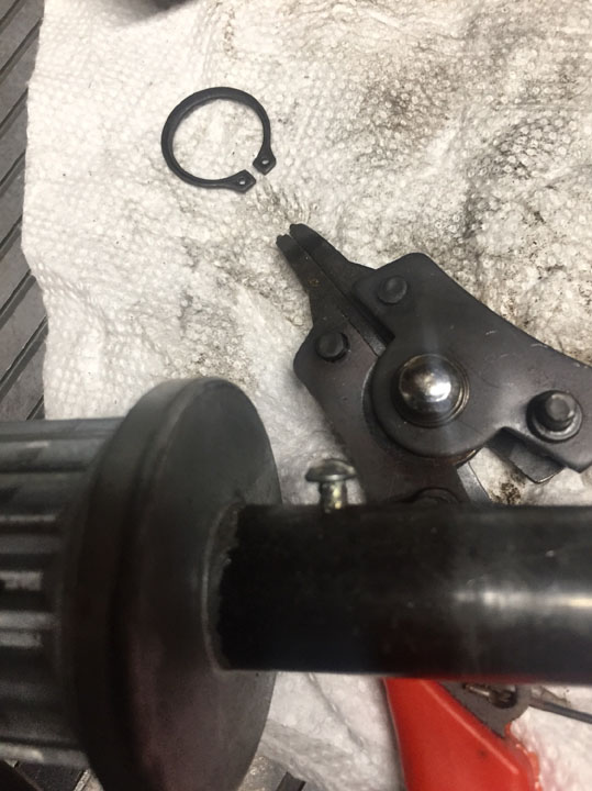

I used a silver paint marker to show where the opening for the keyhole slot because it’s hard to see it once you hook it with a pick and try to slide it over the knob.

Thanks for this subject. The spring on my Mark V let loose. Once I pulled the quill and the advance mechanism I was able to see that the spring simply slipped off. I will now try to tap the "rivet" or pin down since I seem to have the same issue of reattaching the spring and it slips off as I start my reassembly.
