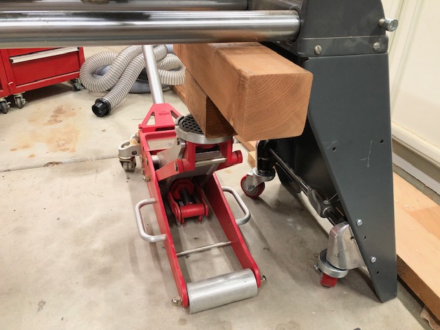

Well, I finally got around to installing the upgraded casters on my 1998 Mark V (original owner). I just wanted to say thank you to all on this thread for their feedback on the install, as well as some of the other previous caster threads I read here. Rather than flip the unit over, as the instructions indicate, I used a floor jack. I think someone else already suggested this on a previous thread here. It worked great. Using a cordless drill, I just went slow and held gentle pressure on the backside while drilling. I used the drilling guide from Shopsmith and had no problems with the location of the holes giving me the desired lift from the casters when elevated that I wanted. For my vintage of Mark V, everything went smooth doing it this way, but I appreciate all of the feedback and suggestions for what to watch out for from past posts here. If you do use a jack, as I did, just make sure you get the jack centered and be safe with it, of course. Shopsmith has the caster upgrade on sale right now, so I highly recommend anyone that has been wanting it to jump on this now while it is on sale. The drilling guide jig is a free bonus right now with it (and well worth it IMHO).
