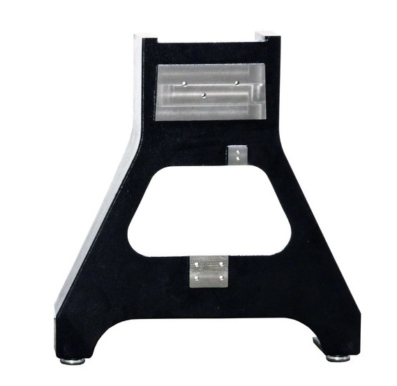

I am 6' tall and have to say that most of what I do on my Mark V works well for me at my height and this is over a few decades with it. Only recently have I started to get into woodturning and for lathe work, the Shopsmith is too low for me to be comfortable to turn on for hours. This has caused me to contemplate ways to raise my Shopsmith, whether it be via a platform, or hydraulic lift, or even swapping out the Shopsmith legs for taller, beefier cast iron legs like below. Ideally I would like the standard Shopsmith height for everything but lathe mode to be taller. So, I think I can understand and empathize with you on machine heights, even though I want to go the other direction with mine.
I also used featherboards for years on rip cuts, but purchased the Jessem Clear-Cut TS™ Stock Guides this year (https://www.shopsmith.com/ss_forum/wood ... 22171.html). I have to say the difference is night and day and I feel much more confident on my long board rip cuts now on my Shopsmith with the simple addition of this after market accessory.
My point with these two different comments is that feeling comfortable using our power tools is important, but often overlooked by many of us. Often, until you experience something different, it is hard to know how important it is to make the change...once you do though, there is no going back. I hope you come to a solution that helps you to feel more comfortable while using your Shopsmith. It really is too bad that Shopsmith doesn't offer more than one leg height, or even the ability to raise/lower it. Some of us would pay for a solid cast iron leg solution to give a bit more heft and lower center of gravity to the machine for woodturning. If these Laguna cast iron legs weren't so darn expensive, I would consider adapting them to attach to the Mark V base...perhaps there are other solutions for leg replacements out there that could help you???
