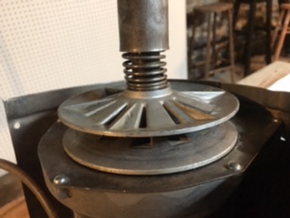

Thanks all for the valuable tips: I have taken off the headstock and removed the motor from the headstock. Once the pulley was removed from the motor shieve, i placed a rag inside the shieve and I was able to push the shieve together, as shown in the pic. I then found the oil hole by looking thru the coil spring. I have placed some 3 in 1 oil, and tipped the motor up, so hopefully the oil can run along the shaft etc. I plan on leaving it overnight.

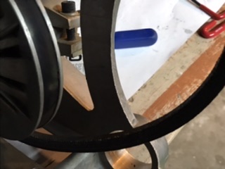

Here are picks that I could not load yesterday. Thinking now it was a file size issue. The second photo shows the belt. When I reduced the size I believe the quality may have been reduced. Just wondering if the belt looks good enough
Thanks

I can't see the belt well enough in the picture to judge it. If it is only showing normal wear then the wear threshold is that it should be a minimum of 1/2" wide measured across the 'back' or outside edge. You can use automotive belt dressing, but it can be messy. You might have abnormal wear if the belt started slipping due to the pulley not moving, but I'm not able to see that in this pic. I would probably use it even if I determined it was time to order its replacement.
It is generally very difficult to use an aftermarket belt even if you can find one. Shopsmith belts are recommended. Recently someone posted details of a metric replacement they got from the Jacob Anderson site, probably also a good belt, and his site has videos stating why he thinks they are an improvement. There are other threads on this subject.
The sheaves should close much further than the other pic shows under spring tension. Maybe just showing how it is sitting while the oil soaks in? The end goal is a small film of oil spread over the full range of motion of the sheave on the shaft. Once it is working right you want to add a few drops of oil on each moving sheave and then run the speed from fast to slow and back a few times while the motor is running to spread the oil.
You got the photo resolution down A LOT! The belt one is 320 X 240 pix.
- David

Yes a fully closed motor pulley should look like the idler pulley in your first picture.

Latest update: I agree with you that the sheaves should be much closer. I used penetrating oil to try to loosen...overnight, just check it....no movement at all. Not sure what the next step would be in correcting this sheave problem.....hopefully you can point me in the correct direction. thanks
