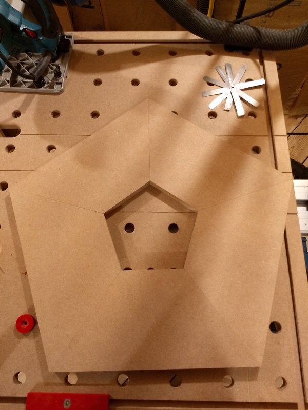

I went down the micrometer-adjustment rathole myself not long ago. With a track saw, that is, and it worked out nicely. It’s hard to beat a 4-1/2’ long “miter bar”, for which you can eliminate all slop.
Here’s some 6” wide acid-test segments, with no post-processing. (Disclaimer: I have no affiliation with Chrysler. :D )

Looks like a perfect 36 degrees!
