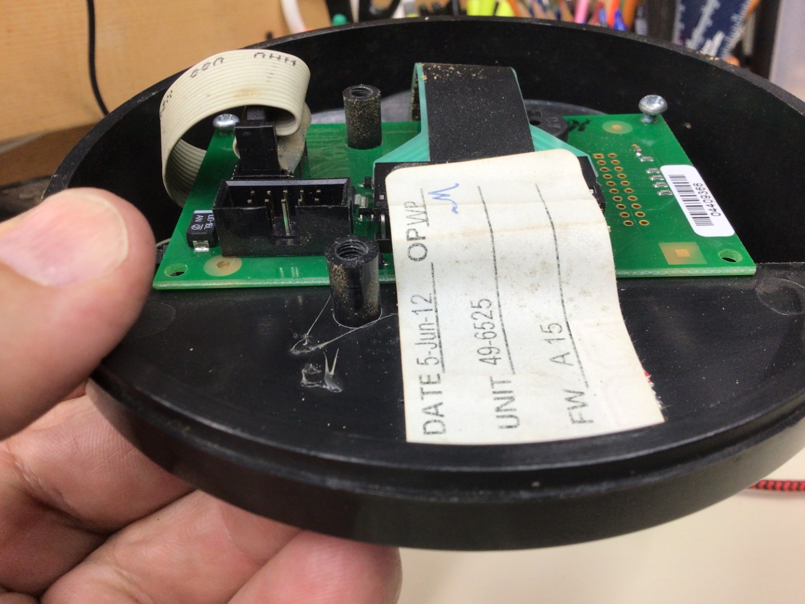

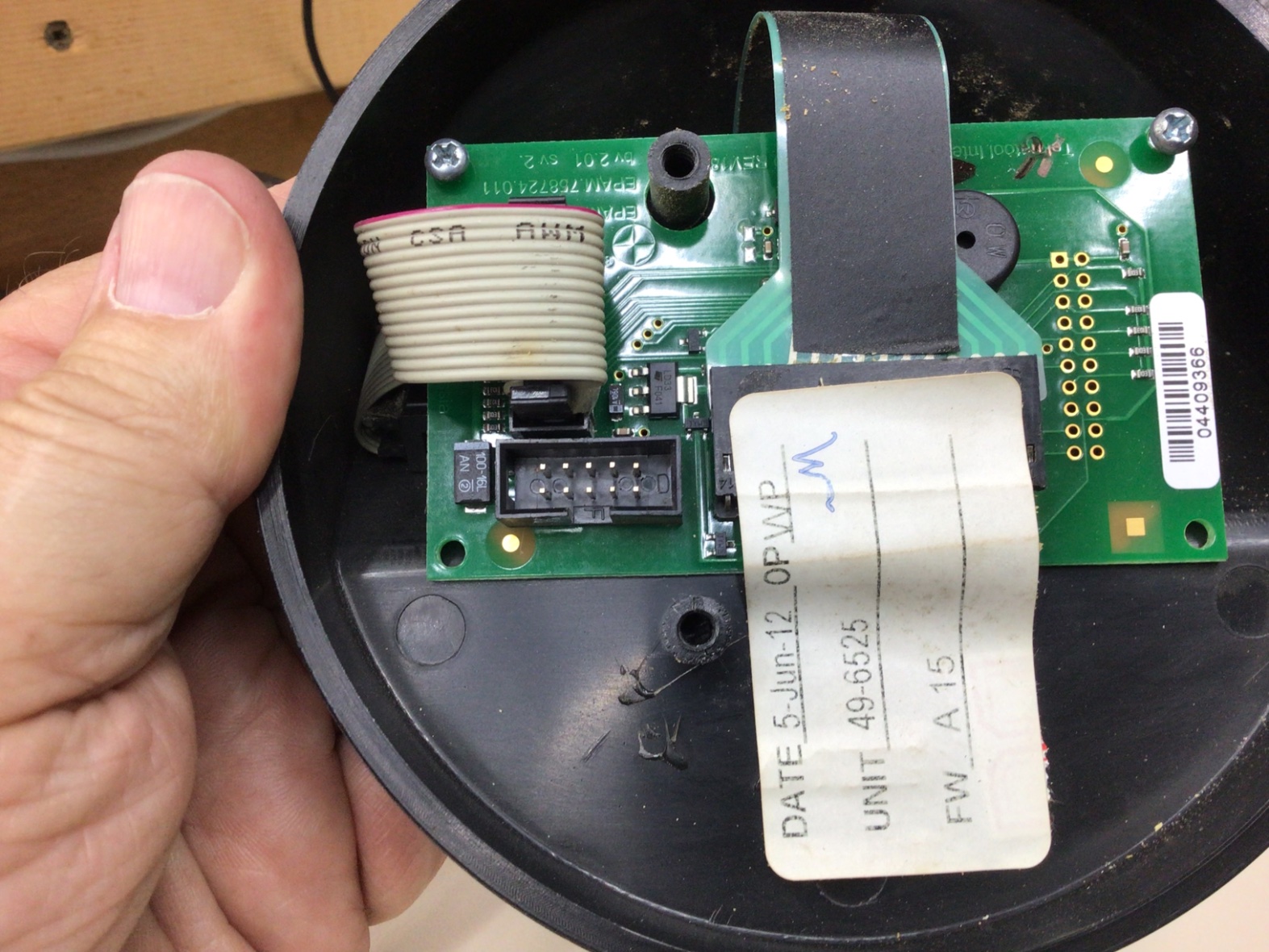

Just got back on my repair project and got down to pulling the control panel off. So far the 10-pin ribbon cable was loose just barely connected and not snapped together (probably explains intermittent power issue and control panel responses). Also took a couple of pics to show that the green circuit board silver mounting screws have been loosening allowing the the circuit board to vibrate —- probably responsible for the ribbon cable to not be firmly attached too.

Interesting. Newer units have a glob of adhesive on those screws, now I know why. I'm not sure what the adhesive is, I had a supplier that used a thick UV-activated adhesive to attach wires to PCBs and it had a similar look. The 10-pin connector doesn't have a latch or snap like the other connectors do. Probably works well enough until the screws start backing out. ;) Were the two screws that mount the assembly to the headstock still tight?
- David
ssuel
Posts: 59
Joined: Thu Jul 20, 2006 12:28 pm
Re: PowerPro - Issue With Control Panel
Post by ssuel »
Yes the headstock mounting screws were tight.
