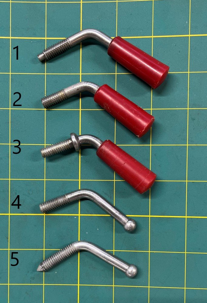

As for using parts specific to the Mark 2 to replace parts, like the Way Tubes, on a Mark 5/V I would recommend not to. There are things that are interchangeable between the Mark 2 and the Mark 5/V. As an example, the second Mark 2 I have came with a damaged Main Table and no Tailstock piece. I already purchased and have been planning to use a Mark 5 Main Table, Carriage, Fence, Extension Table and Tailstock as replacements. Mark 5/V parts used on a Mark 2 can be an improvement but the other way around is not. With so many Mark 5/V parts available both new and used it does not make sense to use Mark 2 parts on a Mark 5/V.
