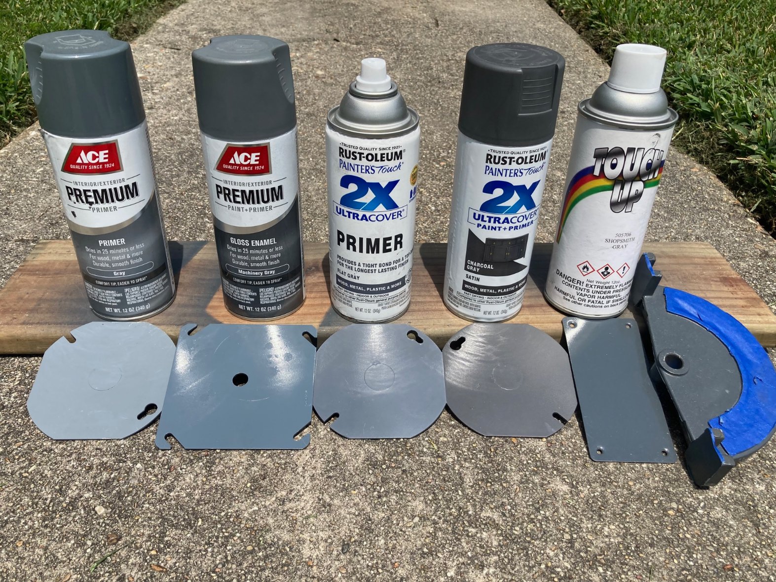

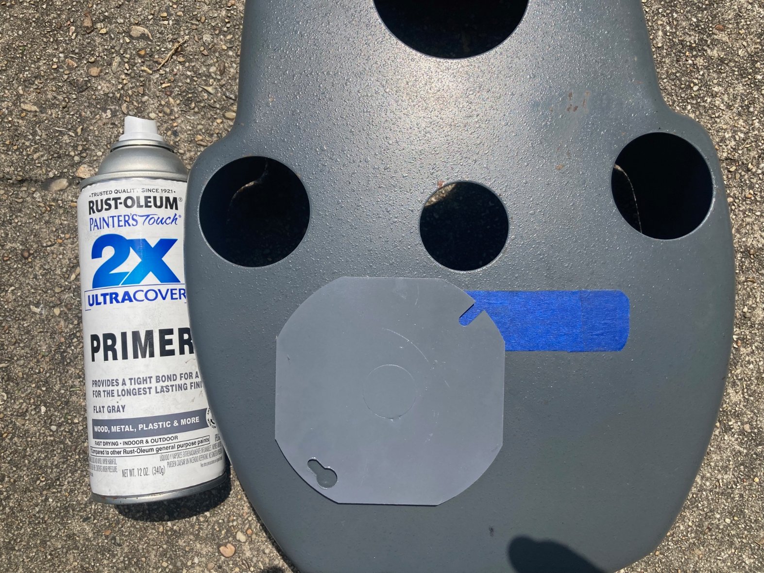

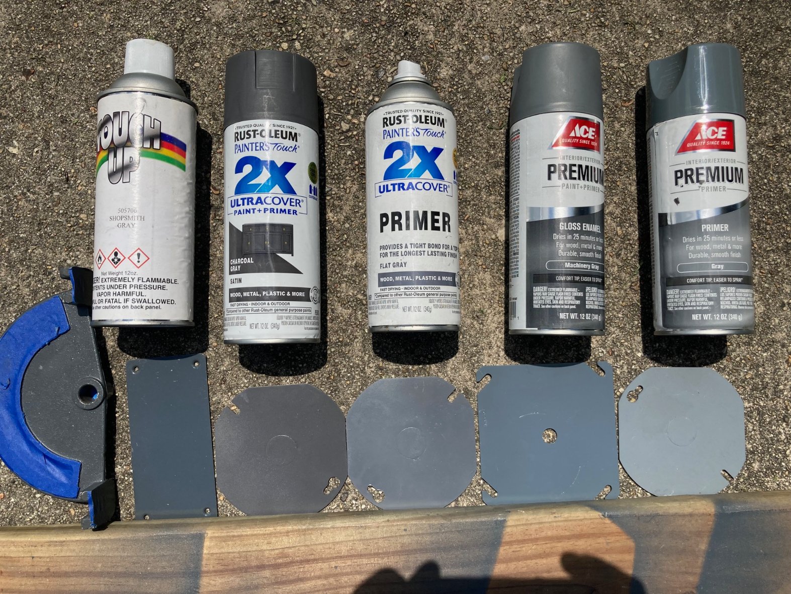

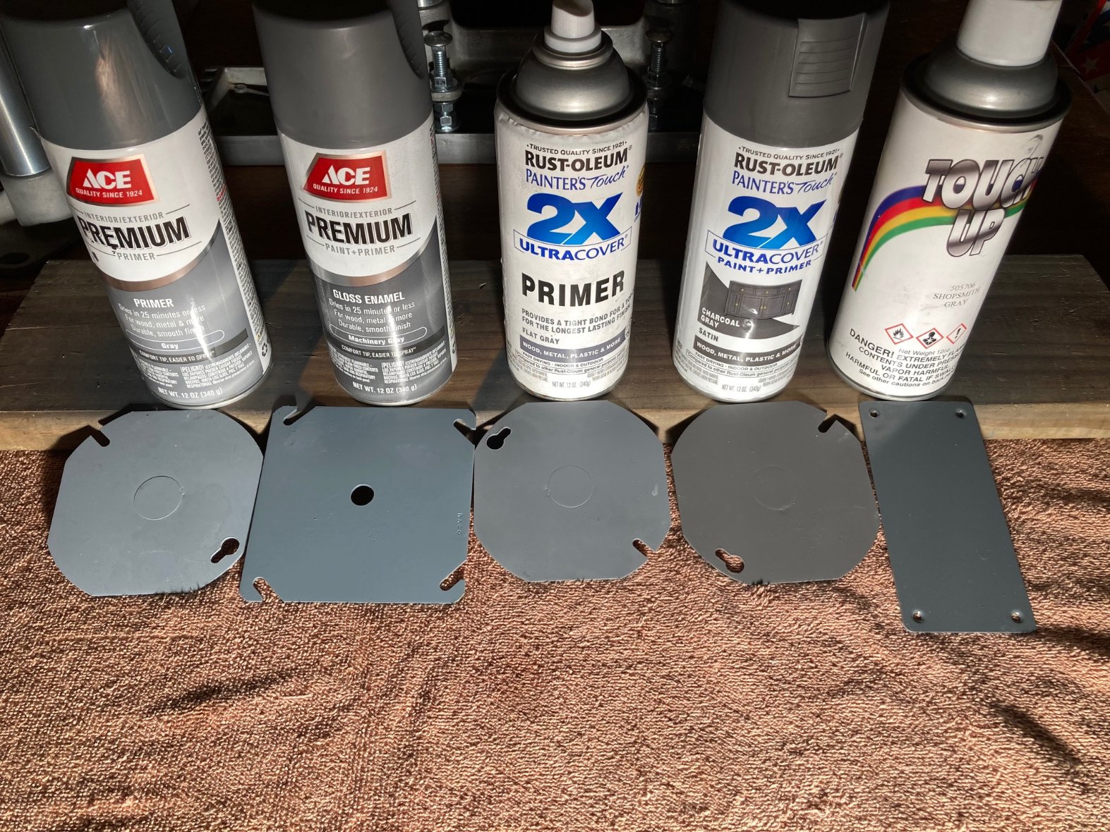

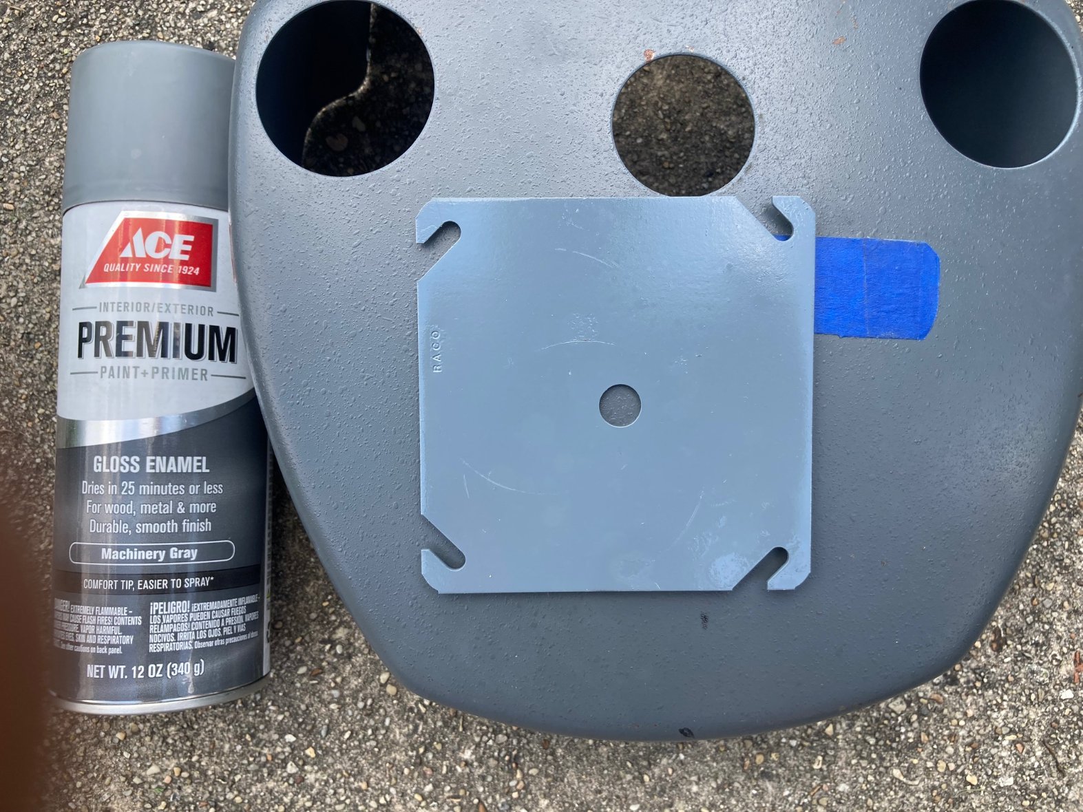

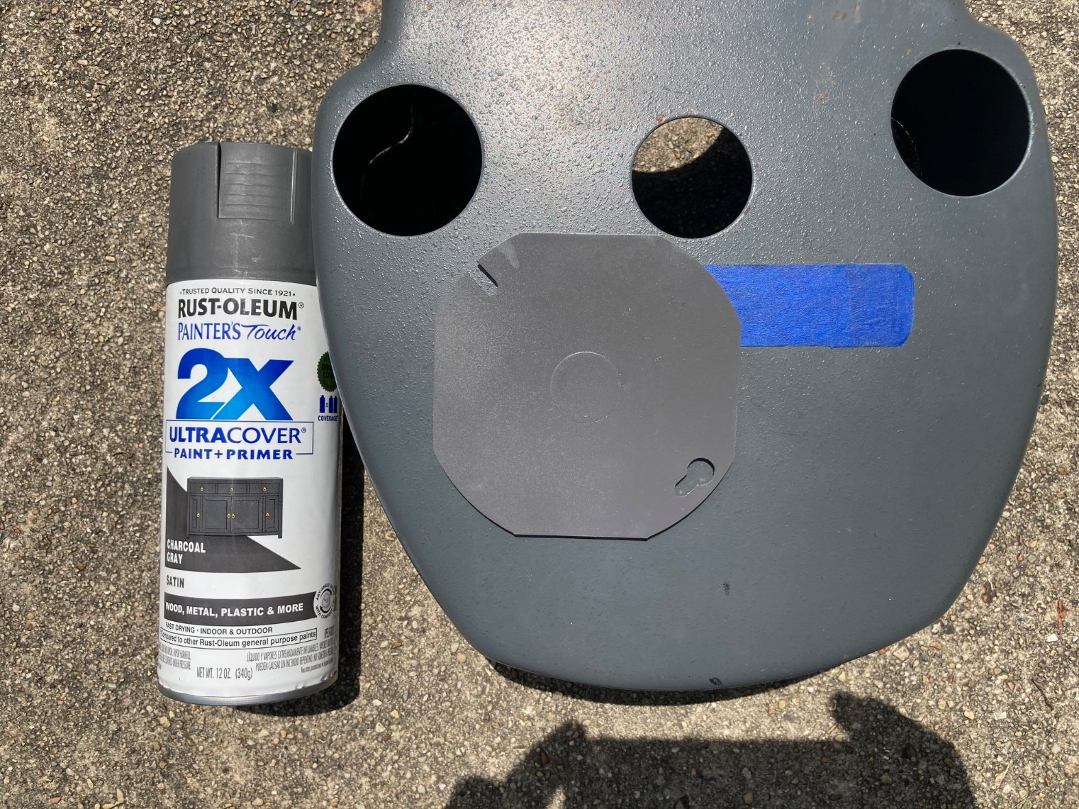

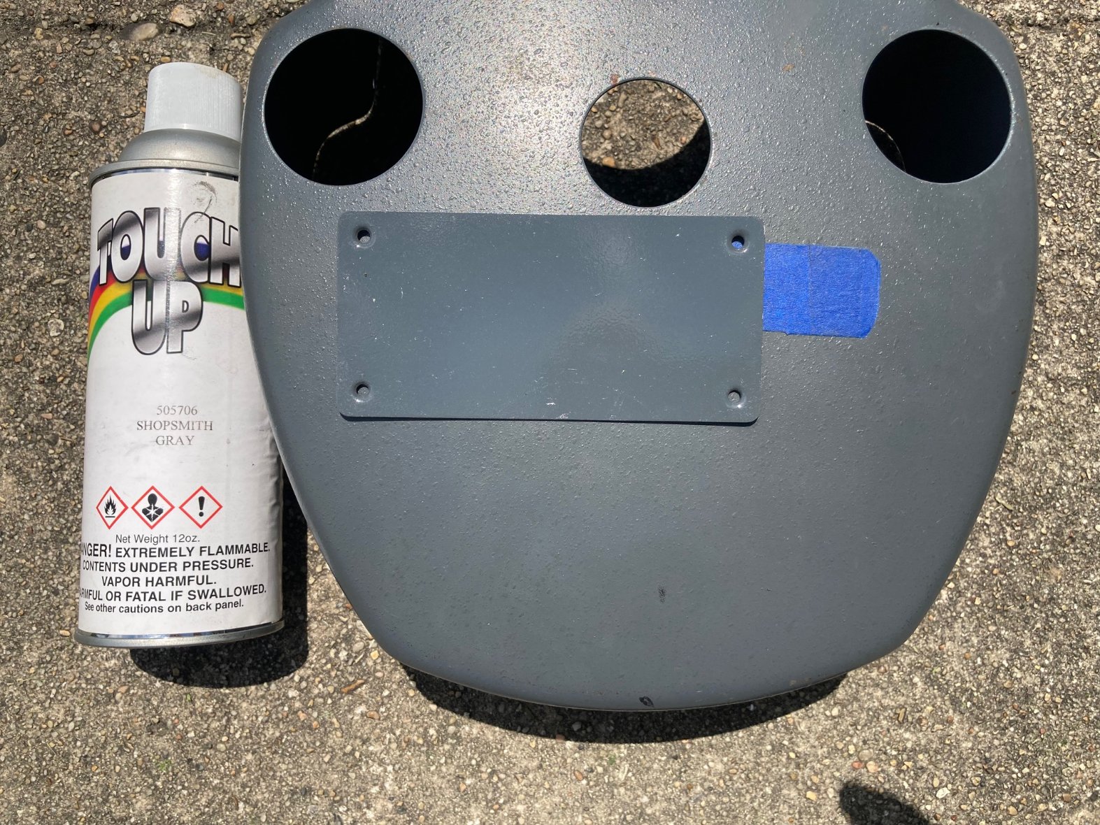

Paint Comparisons:
I wanted to post a few pictures of the various paints I considered before deciding to use the Shopsmith touch-up paint (505706-Before 10-01-2001). It seems to me the closest off-the-shelf paint is the Rust-Oleum 2X UltraCover Paint+Primer Charcoal Gray Satin. Next closest seems to me is, as has already been mention on this forum, the Rust-Oleum 2X Ultracover Primer Flat Gray.
The last two images are of the Shopsmith touch-up paint (pre 2001) compared to the original, 42-year old factory paint on the main table angle gauge.
They seem to match better looking with the naked eye as opposed to looking on the images on the computer screen. I don't know. You be the judge...
- Paint Comp1.jpg (490.97 KiB) Viewed 2487 times
- PaintComp2.jpg (512.74 KiB) Viewed 2487 times
- comparison of SS touch-up paint (pre-2001) and original factory part
- Paint Comp3.jpg (536.37 KiB) Viewed 2487 times
- Close-up of SS touch-up paint and SS original factory-painted part
- Paint Comp4.jpg (515.75 KiB) Viewed 2487 times

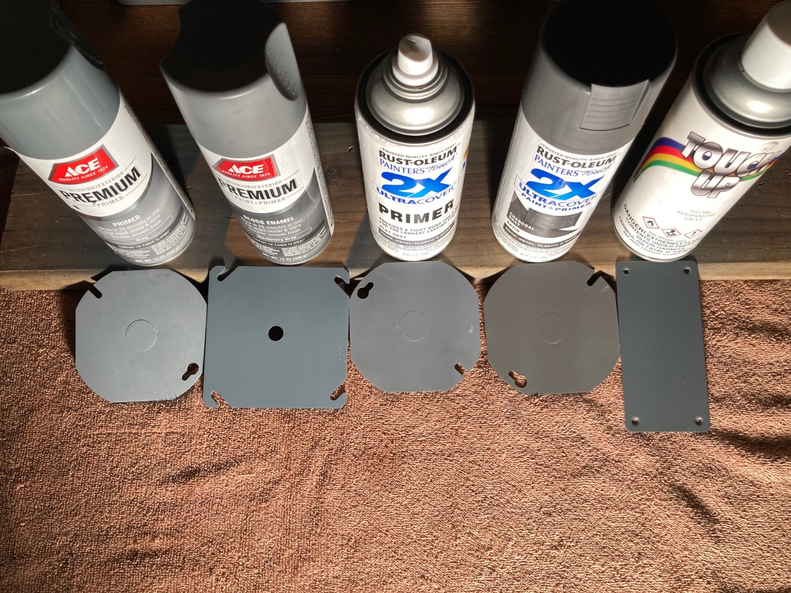

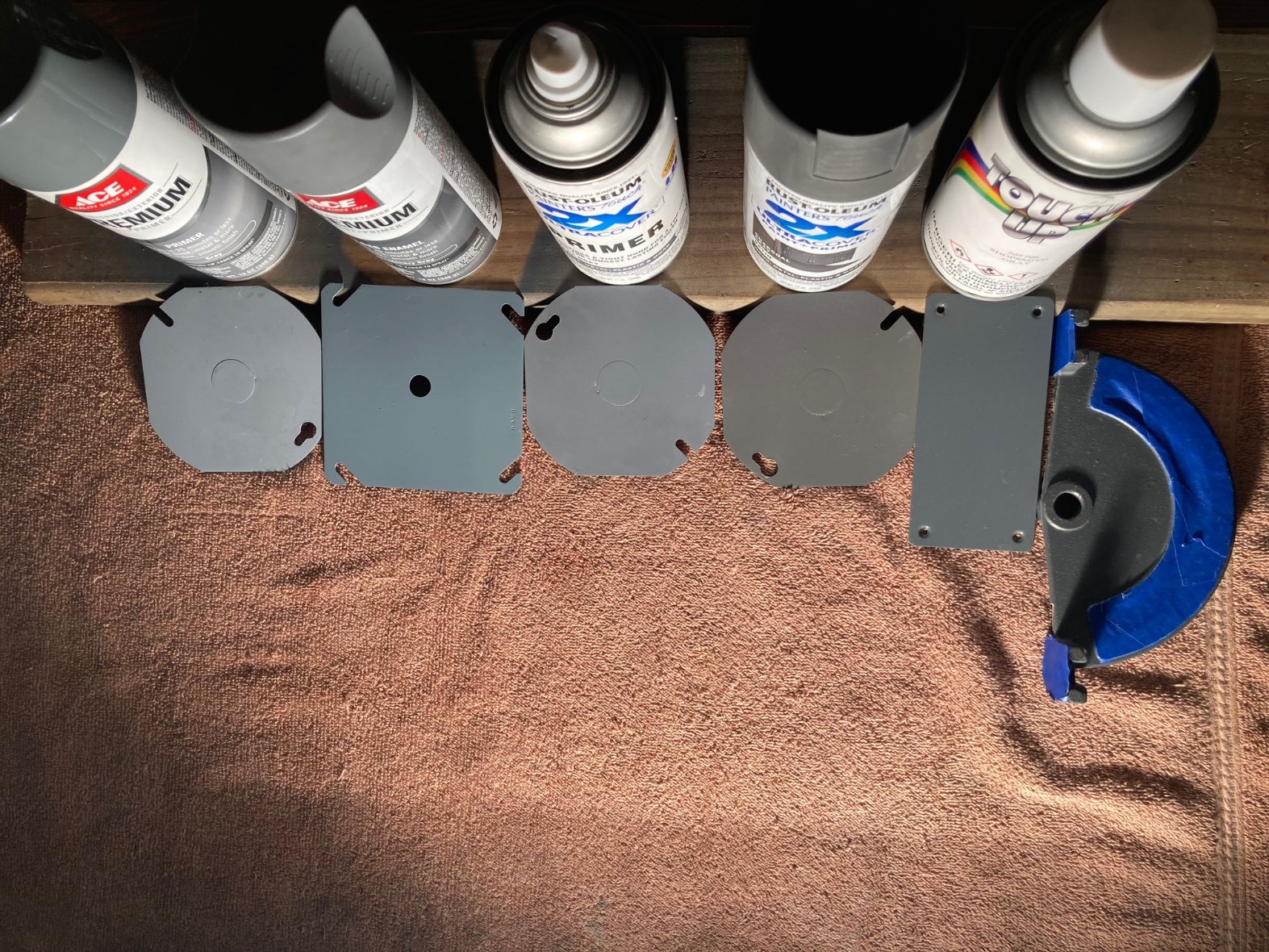

In addition to the difference between computer screens (colorwise), there is the effect of the color temperature of the light illuminating the objects.
I recommend color comparisons ONLY in direct sunlight by direct vision. Not 100% effective but less prone to incorrect comparisons.

Regarding the cost, I had most of those on-hand already from various hobbies and other projects. I've got a large stash of spray paints accumulated from the RC airplane hobby, model rocketry, plastic models and various other projects around the house. In fact, grays and silvers is what I have most of. Anyway, I like experimenting and tinkering so I don't really like to add up the costs of all equipment and supplies these hobbies require: I might have to start scaling back on the hobbies!
I really just posted the pictures of the paint samples so others who might be considering their paint choices other than than the Shopsmith branded stuff. I included those colors because I had seen them mentioned here on the forum on various threads.
I'll take the samples out in the sunlight and take a few pictures to see how much difference the natural light makes.

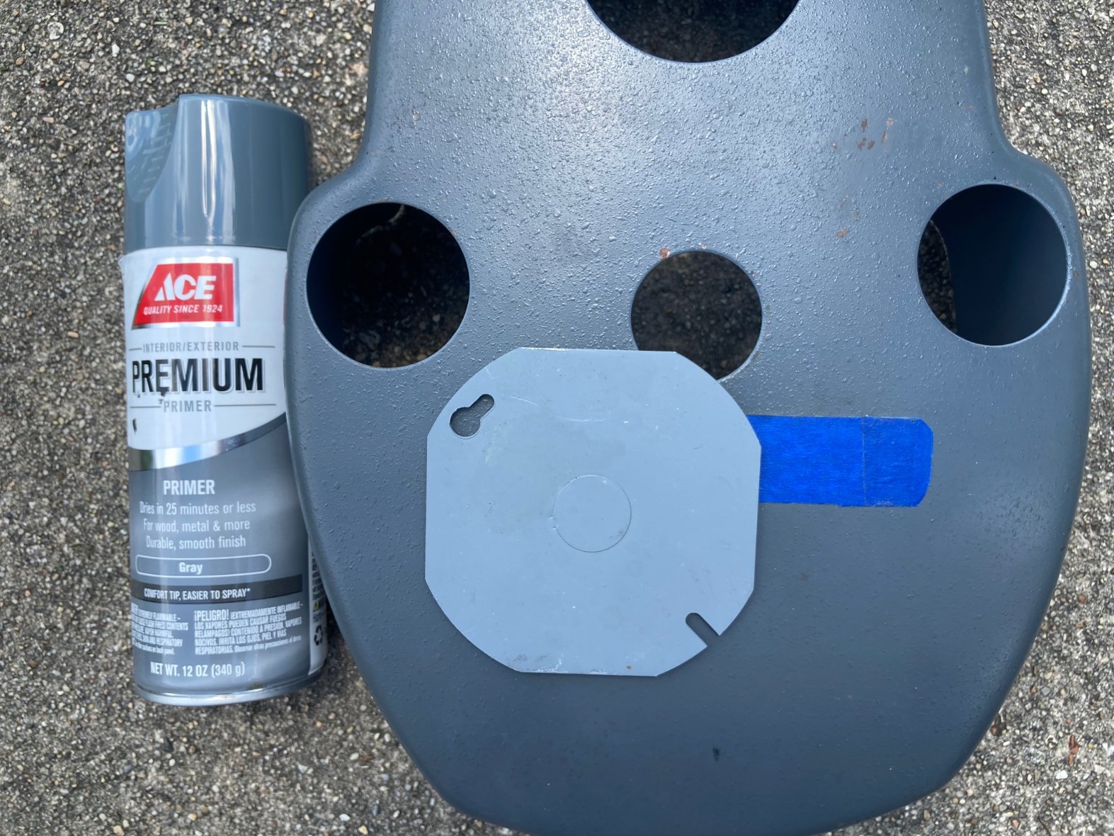

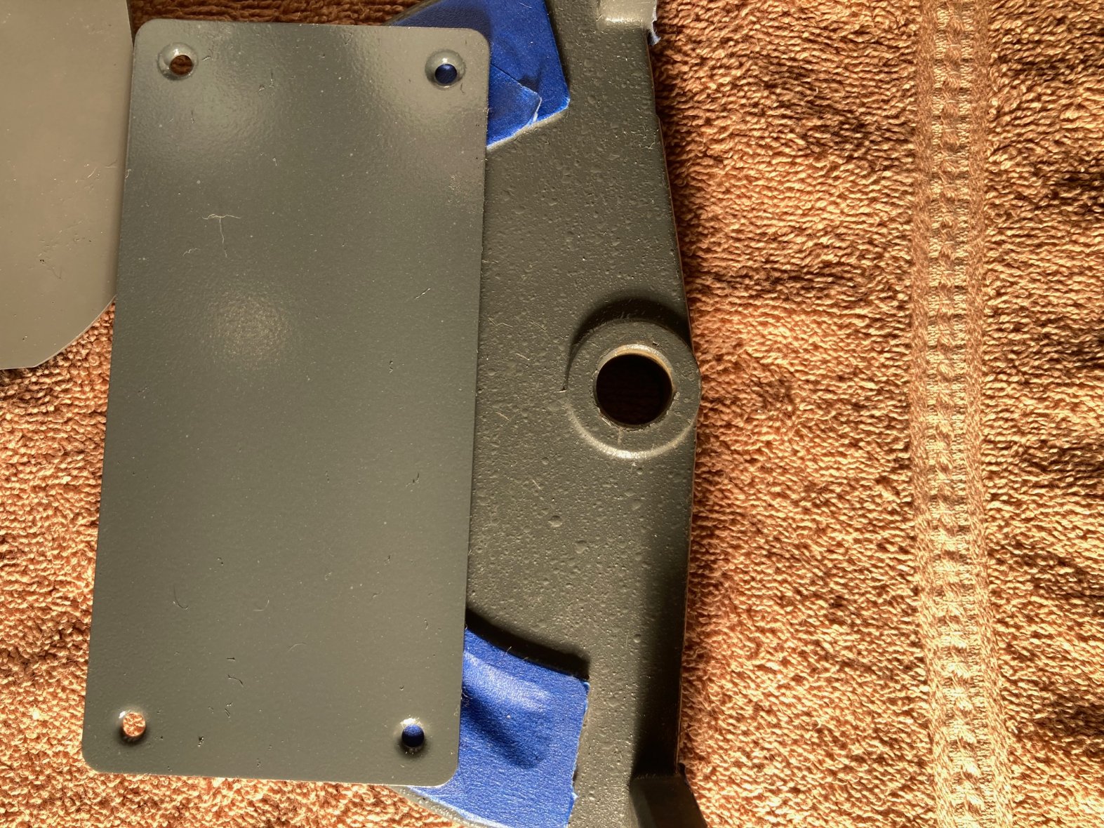

Re: Dad's 1982 Shopsmith Mark V Repair/Restoration Project
I took some more photos of the paint samples in direct sunlight as you have suggested.JPG wrote: Mon Sep 02, 2024 1:00 pm In addition to the difference between computer screens (colorwise), there is the effect of the color temperature of the light illuminating the objects.
- Paint Samples in direct sunlight - front
- Paint Comp 5.jpg (569.35 KiB) Viewed 1922 times
- Paint Samples in direct sunlight- top down view
- Paint Comp 6.jpg (527.74 KiB) Viewed 1922 times
- Sample shown next to original factory paint finish
- Paint Sample 5.jpg (499.42 KiB) Viewed 1922 times
- Paint Sample 1.jpg (519.38 KiB) Viewed 1922 times
- Paint Sample 4.jpg (491.87 KiB) Viewed 1922 times
- Paint Sample 3.jpg (376.21 KiB) Viewed 1922 times
- Paint Sample 2.jpg (383.26 KiB) Viewed 1922 times
