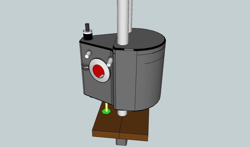

Something like this
[ATTACH]26181[/ATTACH]
The green is the nut
Other thoughts........
Modified to use maybe a 4 by 4 instead of 2 by 12, for more stability and easier to clamp over the way tubes?? :p
Anyway, some food for thought.
Be well,
Ben

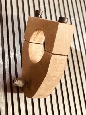

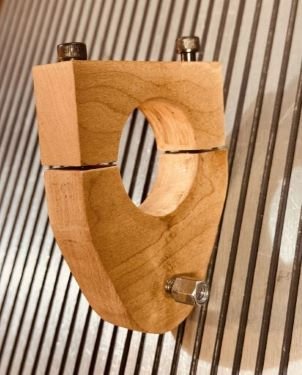

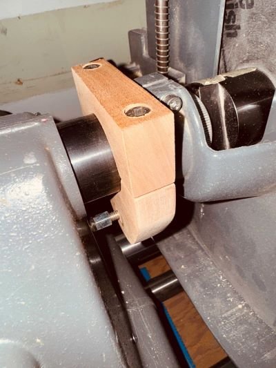

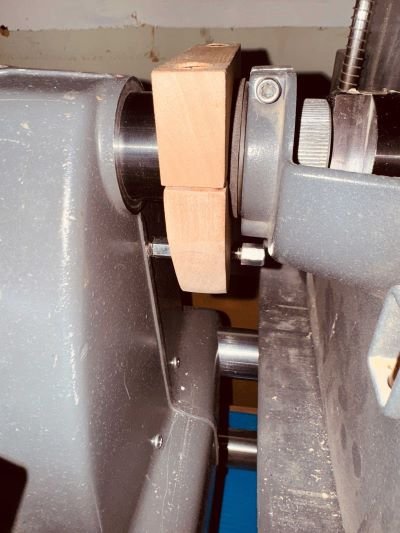

Here's what I did for a quill micro-adjuster.
This is a "take-off" inspired by the post in this thread by STB » Thu Sep 11, 2014
When you need to adjust the quill just a little bit when routing, shaping, sawing, etc ..... this makes it so much easier.
The adjuster screw is a 1/4"x20. A full turn moves the quill .050", one "flat" is .008". The head of the adjuster screw rides on the rib of the SS housing directly under the quill. I can either use a small wrench or my fingers to turn the screw.
I used a tap directly in a hole in the wood to make the threads for the adjuster screw as well as the 2 split-collar screws.
