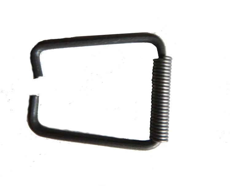

Hi All,
My 42 year old Mark V worked perfectly until a small piece, part 504187, loop, retaining, reference # 75 on the parts diagram, came loose.
Does anyone have information on how it is reattached or how it looks when reattached?
Mine may be bent as the two legs are not parallel now. Is it supposed to have parallel legs?
Thanks for any help.
John Hubbard

Here is the part
_
504189 Control Sheave Retaining Loop.jpg (20.68 KiB) Viewed 1896 times

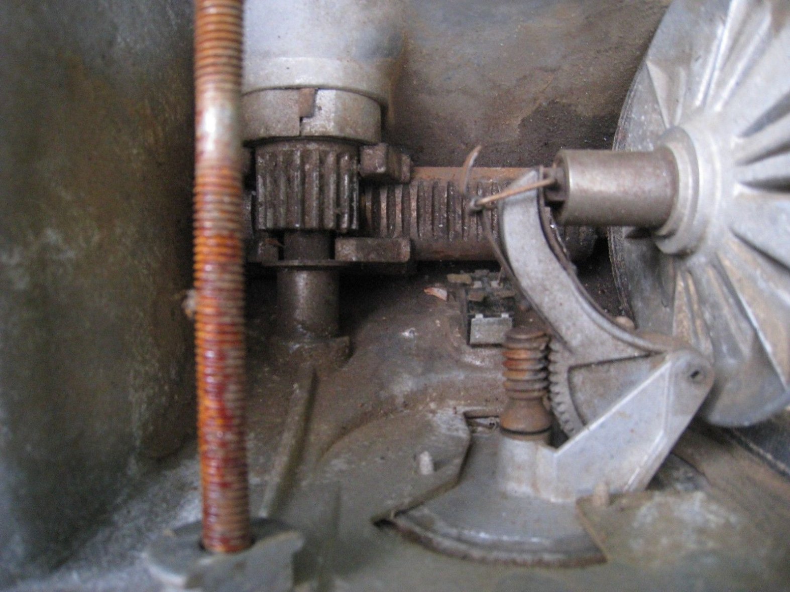

Here it is in position.
_
Headstock B e8.jpg (258.68 KiB) Viewed 1896 times
This headstock needs work. :eek:
