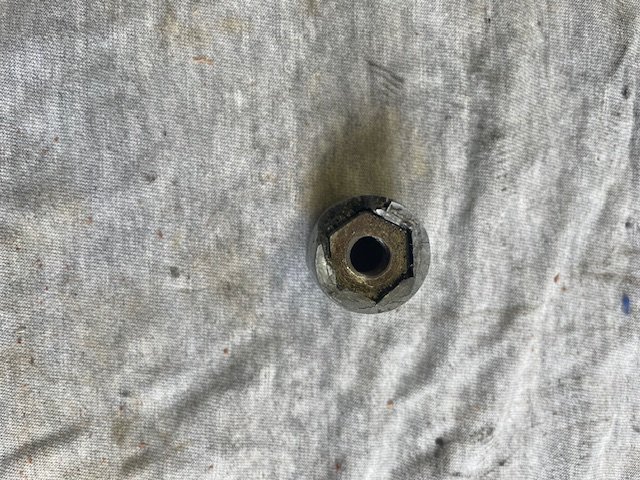

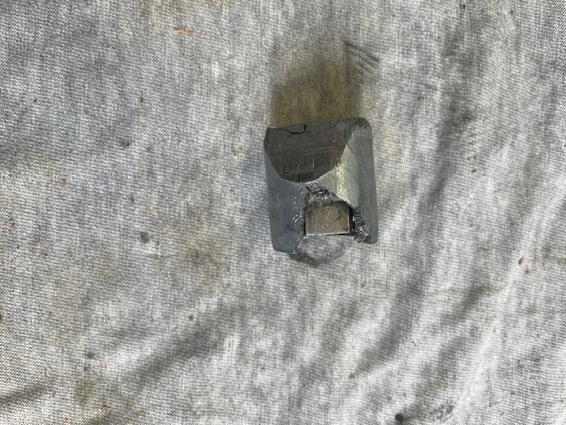

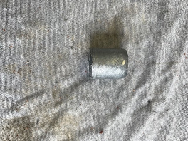

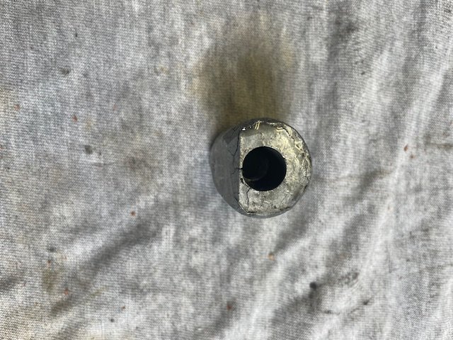

Here are images of the damaged inner quill wedge
- IMG_3968.jpg (108.85 KiB) Viewed 2227 times
- IMG_3969.jpg (86.98 KiB) Viewed 2227 times
- IMG_3970.jpg (105.75 KiB) Viewed 2227 times
- IMG_3971.jpg (107.64 KiB) Viewed 2227 times
- Posts: 4538
Re: Head stock and carriage stock wedges Model 10E
dust,
Thank you for posting the pictures. What I see would be hard to describe. The first picture shows the end rounded somewhat. I haven't seen a wedge with the end rounded like that before. The damage around the nut shouldn't happen in normal use. Either the casting was bad or it was damaged outside of the Headstock.

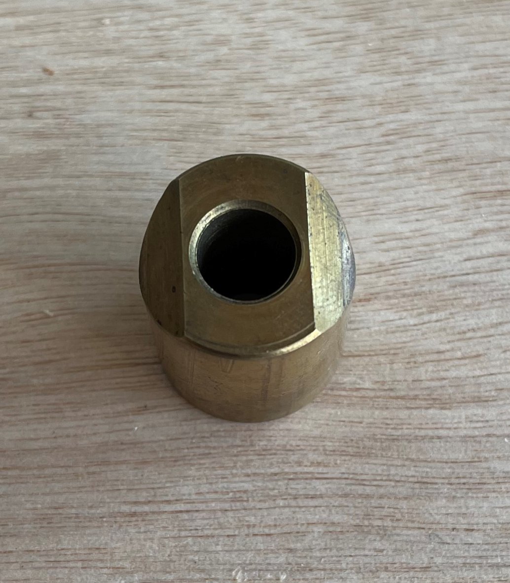

Something my previous pictures didn't show well is the brass wedges have both sides beveled to go against the Quill or Way Tube as seen in the picture below.
_ .
Having a single bevel like the later alloy wedge or a double bevel like the brass wedge above, know that either will work fine. The only plus to having two bevels on the wedge gives a second surface to go against the Quill or Way Tube should the first bevel becomes worn. It will take a lot, and I mean a lot, of use to wear on the brass wedge. As you can see on the brass set of locks, I previously posted and the wedge above, there is very little wear on them. Pretty good since they are from 1947. That's a lot of years of use.
