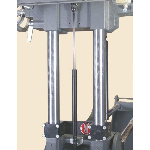

I recently bought a new to me 510 after I lost my original 34 year old 500 in a fire. On the carriage and the right tail piece mounted with screws to the bases is a small 3/8 to 1/2 ball joint I don’t recognize. Searched my documentation can’t find out what it is, or maybe I’m missing some pieces. THOUGHTS?

If I were to guess I'd say they're probably part of a lift assist

Perhaps the Gas Spring Table Raiser - https://martins-supplies.co.uk/presta/d ... v-510.html
That would attach to the carriage and the casting.

The Gas Spring Table Riser for use when in Drill Press Mode is what I believe Docdare55 describes attached to his Mark V. Shown below.
_ .
Not the Lift Assist for raising to the Drill Press Mode as shown in the picture below.
_ .
As you can see the Lift Assist has the Threaded Ball Studs attached to the brackets for the ends of the Gas Strut. The Gas Spring Table Riser, that Ed provided the link to, uses a gas strut between the Carriage and the Base to help adjust the Table Height for Drill Press Mode.
Those are the only two accessories I can think of right now that have ball joint studs for the Mark series tools.
