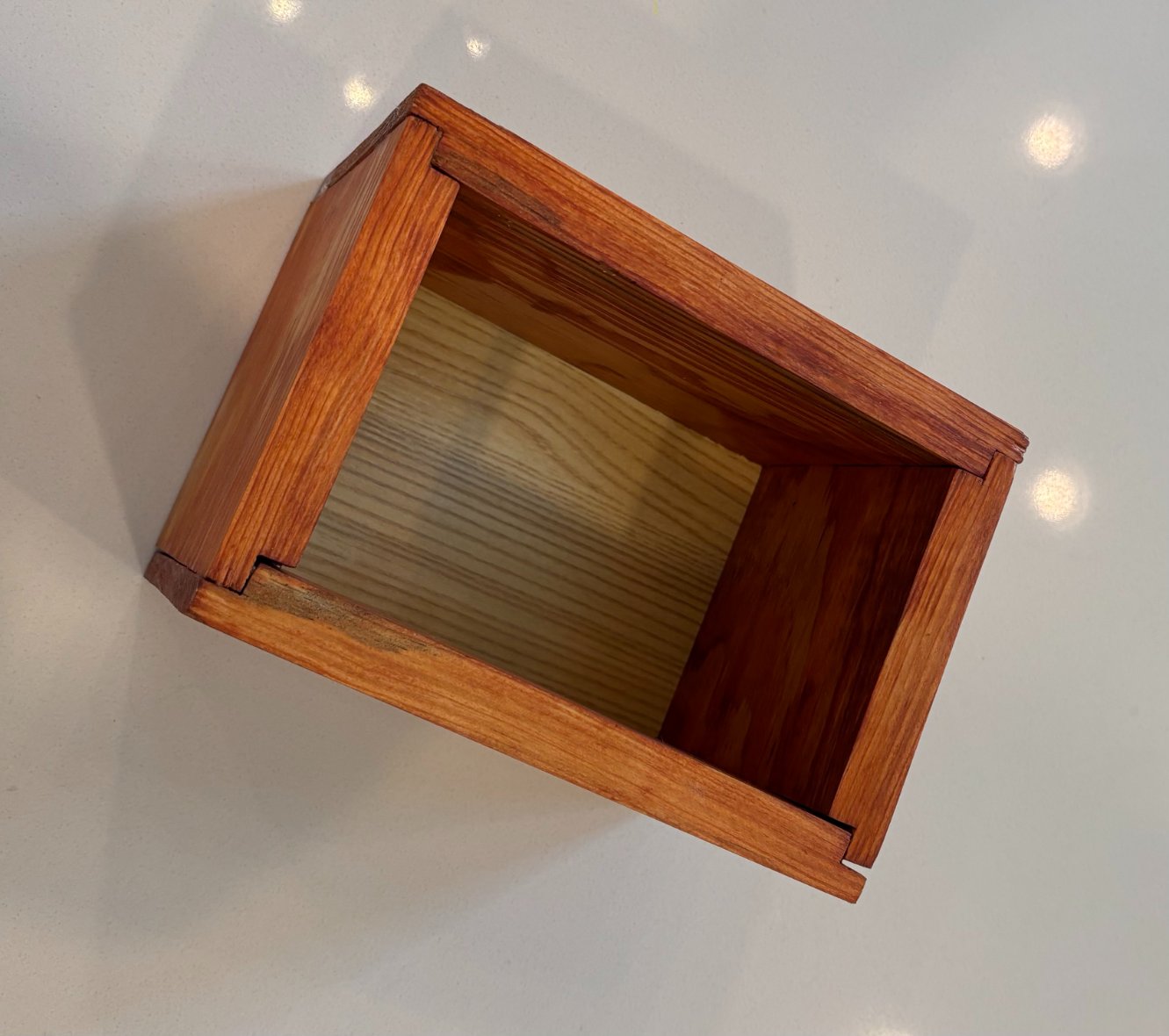

Hi guys. Thanks for your advice and my apologies for my delay in response. I guess I was making sawdust?!?!?
I ended up making a box out of the lousiest 1x6 you have ever seen for a practice ran. It was reasonably good for a first attempt. I learned a ton such as you MUST pre stain/seal pine to avoid splotchiness and use two band clamps to keep your joints tight while glueing instead of one clamp, which can pull the boards out of square. It lives on my workbench now, holding odds and ends.
I am 99% done with the larger poplar box I made for my daughter. It is both better made and took me less time to make than my first box. I will post a pic tomorrow when I take the clamps off. I wanted to make use a different joint, but to get the dimensions and grain I wanted I had to use a double rabbet corner joint again. I like the look of the wood but was surprised to learn poplar is quite a bit weaker than many hardwoods. It was easy to work with, reasonably priced and locally available, all plusses.
I worked on a dice tower tonight out of pine. It was an easy design and build but tedious, since I don't have a dado blade.
I looked at the SS miter goodies. Those look very helpful. I still want to make a picture frame, and if I can get it to look good, will make some frames for new art for my office. I bought an ornamental router bit for frames, but am a little intimidated by the size of the bit. I don’t want the router to get away from me and I don’t have a router table. I may make an outdoor cedar planter first. (another box!
Again, many thanks for your help and advice,
Karl

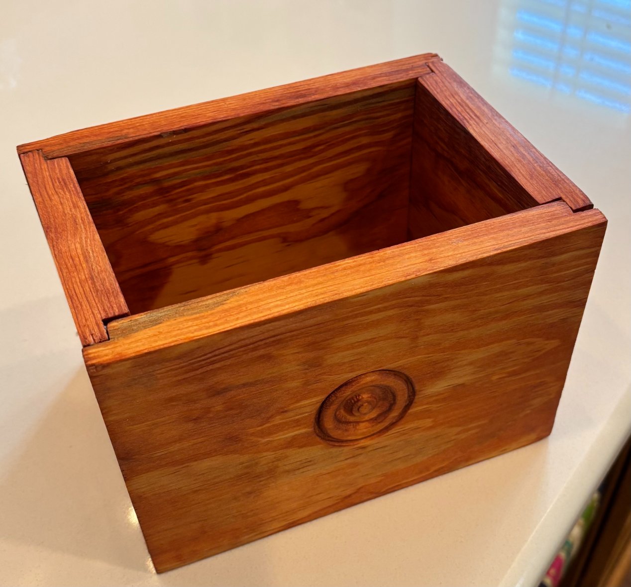

Another pic of my first box
