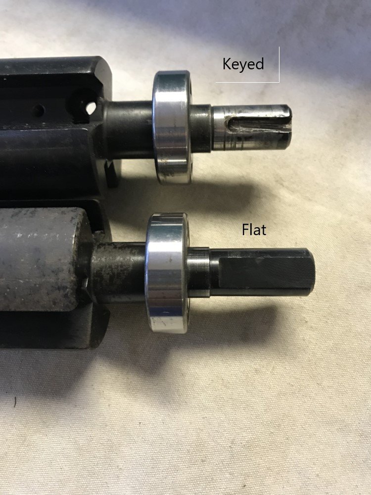

and bought cast iron pulleys from Grainger. For the motor pulley I bought a 3.45 inch (AX pitch diameter= 3.2 inch) and for the cutter head a 2.75 inch (AX pitch diameter 2.5). The motor pulley was about as large as possible to fit into the pulley cover. The cutter pulley was as small as recommended for use at the expected speeds with a standard cogged AX V-belt. So I compromised on cutter speed. Rather than the 5750 RPM with the pro-planer, this arrangement gives me 4416 RPM at the cutter head - better than the previous arrangement of the stand mounted planer that was 3450 RPM. The motor shaft was keyed but the cutter head shaft had a standard SS reverse taper. So I shaped a key to fit the pulley keyway and the reverse taper and then used Loctite on the key and set screw. I have read alot of posts about the cutter head pulley going off the "rails (i.e. shaft)", including a post showing a pulley welded to the shaft! I now added a regular inspection of the belt and pulley to my maintenance program.
It sounds like you have an earlier Mark Mount Planer Cutter Head. The picture below shows both a keyed shaft and a reverse tapered shaft on the Cutter Heads. Later ones had both a Keyed side and a Tapered Flat side to the Cutter Head Shaft. No longer a need to have separate Mark Mount Planer and Pro Planer Cutter Heads. I don't believe the extra step of making a key to fit the pulley and reverse tapered flat is necessary. The set screw of the pulley against the reverse tapered flat should hold just the same as attaching a Power Coupler Hub for use as a Mark Mount Planer. The pulley may need a longer set screw to reach the reverse tapered flat than the one originally supplied.

Russ - The failed pulley was mounted in that fashion with a long set screw through the pulley keyway to the reverse taper and seemed to have slipped and sheared the set screw. That was a Congress pulley, probably zinc so maybe it failed unrelated to the set screw position. Certainly would have preferred the keyed cutter shaft. I considered drilling and tapping a separate hole for a set screw away from the keyway, but I got lazy.
