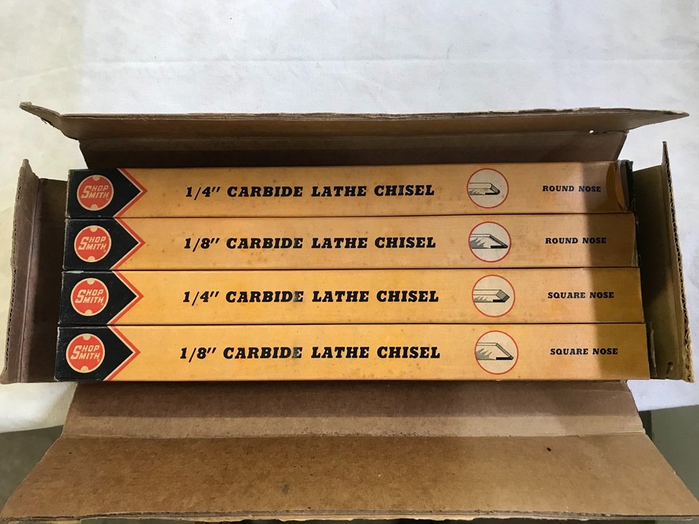

Lathe Chisels part number 12 301 were an accessory item that did not come with the purchase of a Mark 5. For 1954 they would be the second version of the Lathe Chisels with a red logo stamped into the handle in a box from Magna Engineering Corporation. This version predates the introduction of the Mark 5 but carried over to it.

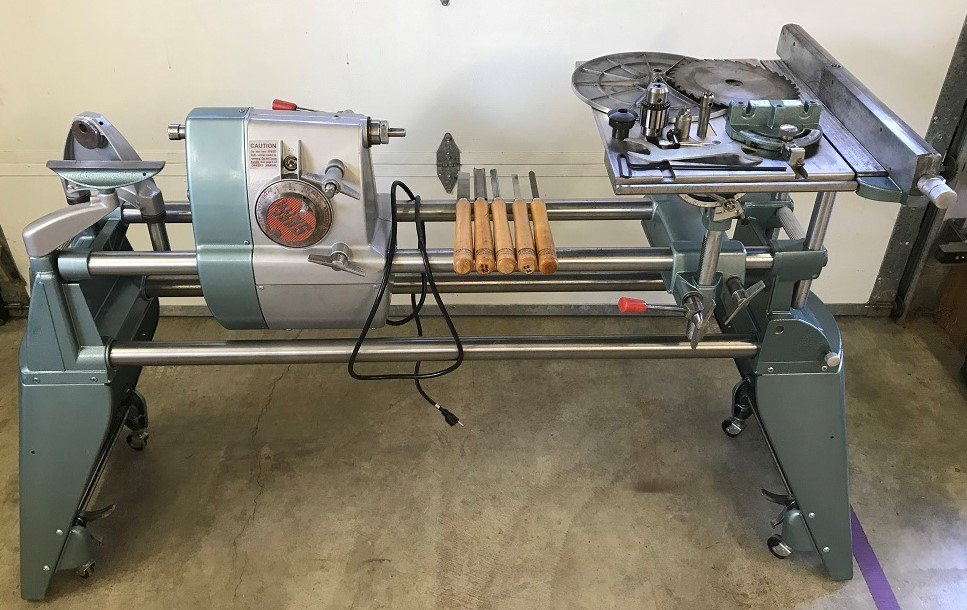

I am curious as to the serial number of your Mark 5 Greenie to see when it was made and if that was prior to the introduction in March of 1954.I have a 1953 greenie that I restored
Re: Accessory Box Question
I miss typed when I first posted. I believe my Greenie is a 1954 model. The serial number is 265359. It was given to me by the son of the original owner. It came with the original sales packet that had brochures and other items along with a letter thanking him for his interest. The letter has his name on it which is pretty cool. It also came with a lot of accessories, some in boxes and some not. I restored it but could not get original paint so it is charcoal gray and silver at this point. I just saw that a guy on Ebay is selling what he says is custom mixed original green and silver green so I bought some. I will probably repaint mine to the original green this winter.
Thank you for posting the pictures and sharing the information. I do have the original lathe tools and one carbide tipped lathe tool along with the jointer cutter in their boxes. I have been watching for an original key switch in it's box but they are rare. I do have the upper and lower saw guards but they must be newer than my machine because the don't look like your picture. I too have never seen any Greenie saw guards in their original boxes.

Your Greenie serial number 265359 was made in April 1954. Its great that some of that original paperwork was still with it. Nice pieces of history.
I have a 1957 Mark 5 Greenie to restore plus a Mark 2 and SPTs. I have been looking for paint colors in the Hammered Finish original to the Mark 5 Greenie colors. I have seen the paint I believe you are referring to but I am not looking at it as an option. I have been experimenting with green colors and using a clear Hammered Finish topcoat. The common green paint used for years for restorations was Rust oleum Hammered Finish Verde Green but was a bit off to be correct. I like the Rust oleum Hammered Finish silver just need a green option. Below is a previous Mark 5 Greenie using Hammered Finnish Verde Green and Silver that I restored.

There were 4 carbide tipped Lathe Chisels made in that era. The single boxes were grouped together and also sold as the set of 4 in an outer box as seen below.

Very nice restoration. It is beautiful! One question though, isn't the original silver color more of a silver/green? Mine looked like a silver/green when I got it but maybe that was just aging.
I have one of the carbide tipped lathe chisels but not in it's box. The one that I have is the 1/4" round nose and it came with my Shopsmith. The carbide tipped tools are rare and I have never seen one in it's original box. Very cool set you have there.
