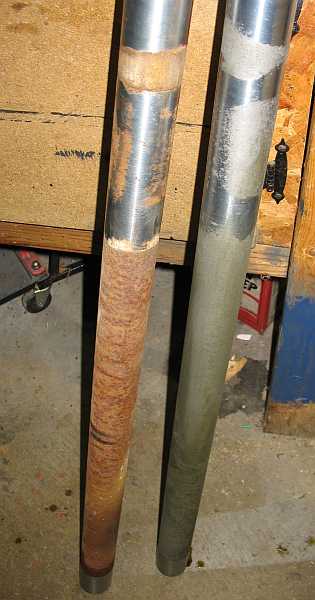

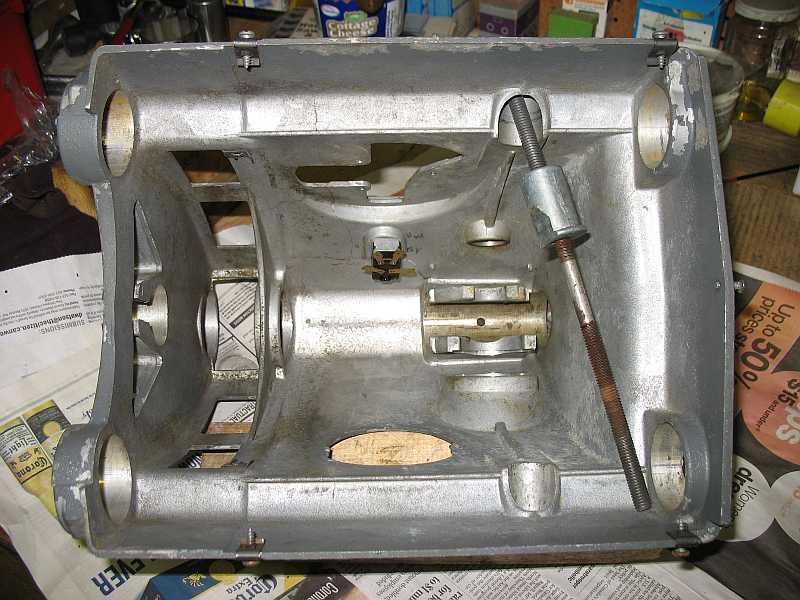

Actually, that _IS_ "ABS" plastic tubing I bought!!!! Maybe that's what they call PVC tubing up here? It's the black plastic stuff made for plumbing uses.

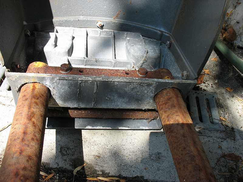

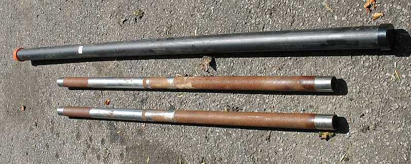

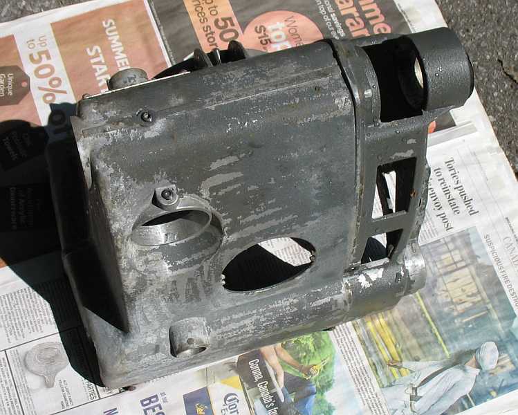

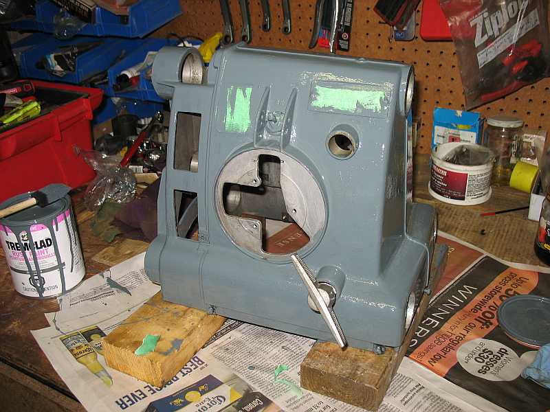

Anyway, here are a few pictures of my progress, using evaporust on the tubes, and cleaning and painting the headstock cover (using foam brush and grey tremclad/rustoleum paint).
Cheers!
Cheers!
[ATTACH]5564[/ATTACH]

- sshead_before.jpg (67.42 KiB) Viewed 2307 times
- sshead_clean.jpg (73.39 KiB) Viewed 2305 times
- sshead_after.jpg (77.1 KiB) Viewed 2306 times
- sstubes_before.jpg (74.28 KiB) Viewed 2305 times
- sstube_after_evaporust.jpg (34.4 KiB) Viewed 2306 times

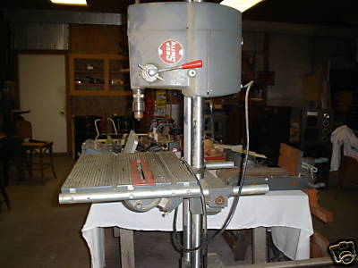

This is what I will tackle next (once I get the tubes de-rusted): the legs (trying out the attachment display feature, which I've just found out about!):
[ATTACH]5571[/ATTACH]

Tubes after evaporust and sanding

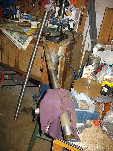

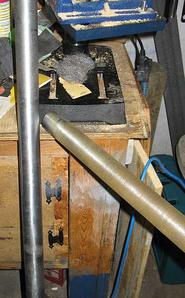

Evaporust has removed most of the rust off my top tubes (solution is getting pretty black so likely won't do too well on the lower tubes, unless I buy another gallon...).
I had bought a selection of sandpapers
[ATTACH]5576[/ATTACH]
I inserted the pipe in the vise, protected by a rag, and proceeded to hand-sandpaper them in a rotating fashion, first by grabbing the sandpaper in one hand, clasping the tube firmly, and scrubbing vigorously in a circular motion around the tube, up and down the rusty areas. Then grabbing the sandpaper ends and going at it like shining a shoe, back and forth, letting the paper glide over the tube and doing the fine sanding. Turning the tube over to do the bottom. Going from coarser to finer paper. One of the muscles in my forearm was starting to cramp up so I took a break.
[ATTACH]5577[/ATTACH]
You can see the final result after using 400 grit (the one on the left was done to 400, and the one in the vice is just starting to be sanded):

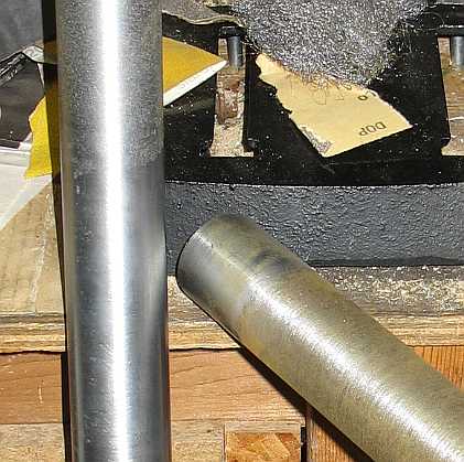

A closer view, showing some pitting on the completed tube:
[ATTACH]5579[/ATTACH]
I wish I had the right attachment to do the final drill-based polishing, but you know what, I think this is plenty good for my need! With some paste wax this will look good, and allow the headstock to glide easily across it. So on to the other aspects of my "fixing up" this neglected Shopsmith.
