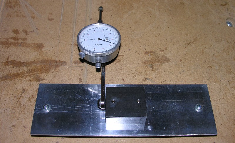

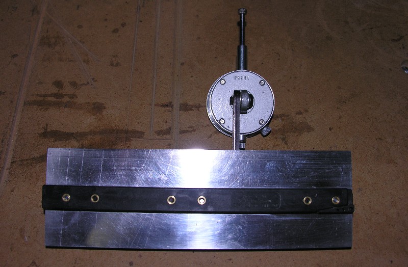

Coincidence. Today I used the dial indicator to check the blade, adjust the bed and blade parallel alignment, etc. It is really simple to use and provides a nice degree of accuracy. Some folks may think it is over kill, but I liked using it. What would be helpful is knowing how much runout a blade can have and how much a bed can be off in alignment. I found it did wobble in the T tracks a bit, and there was no apparent way to tighten it. That made measurements a bit tedious. I think I'll look for a better T track solution, but keep the dial indicator.

[ATTACH]7480[/ATTACH]
[ATTACH]7481[/ATTACH]
- DialIndicator1.JPG (127.25 KiB) Viewed 2886 times
- DialIndicator2.JPG (113.13 KiB) Viewed 2884 times

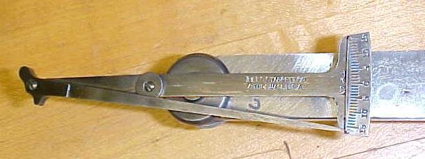

Some where I have some old run-out indicators That are shaped like a narrow piece of pie a couple of inches long and have marks along what would be the crust edge. The pivot on the arm is at the pointed end of the piece of pie. The long end of the arm is the needle pointing to the marks and the short end out past the pivot has a tiny ball shaped follower that is like the contact on the dial indicator. I hope I am describing this well. I looked for a picture but I must have been searching with the wrong terms. Those were very cheap to buy but would serve well for this type of alignment. I "guess" they still make them.

F I N A L L Y ! ! ! !robinson46176 wrote: Some where I have some old run-out indicators That are shaped like a narrow piece of pie a couple of inches long and have marks along what would be the crust edge. The pivot on the arm is at the pointed end of the piece of pie. The long end of the arm is the needle pointing to the marks and the short end out past the pivot has a tiny ball shaped follower that is like the contact on the dial indicator. I hope I am describing this well. I looked for a picture but I must have been searching with the wrong terms. Those were very cheap to buy but would serve well for this type of alignment. I "guess" they still make them.
I have been looking for a picture of one of these since I made the post above. This picture is pretty close to the ones I have here "somewhere". Mine are more pie shaped but the principle is exactly the same. I finally found this picture where some were listed as antiques for sale. (OK, I am an antique...)
They are very simple and not much to go wrong as long as you treat them decent. BTW, they are asking $40.00 each for these.
[ATTACH]7537[/ATTACH]
