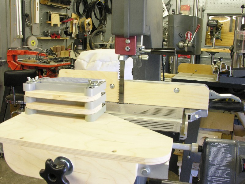

I have the Kreg Fence on one of my saws and it works great. The deeper front rail is handy, but I don't know if I am sold on it being any better for resaw.
ldh
[ATTACH]7903[/ATTACH]
[ATTACH]7904[/ATTACH]

Idh, looking at your photo, do you have to remove the rails to replace your blades?

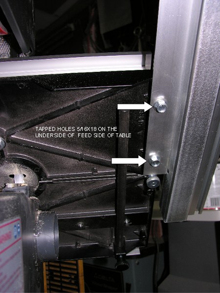

The rail bolts just to the left of the table slot and you have enough room to change blades without having to remove it.
ldh
[ATTACH]7907[/ATTACH]

Pat in your second picture that is quite a resaw set up. Is the stacked feather board system somehow mounted to the extention piece of the table? Looks like it has an adjustment on the side. Any chance of seeing that closer or getting a set of plans. I am getting into resawing and new at it but sure is a better way to get some cheaper wood for turning pens and small projects.

I am not a fan of the Kreg Resaw Guide, but many of the members of the forum have built similar guides to fit the SS fence. I am sure someone has modified the Kreg Guide to work on the SS fence and will jump in here with some pics. I modify the guide bearing setup on my saws and I have had the best luck with the regular SS fence for resawing.
