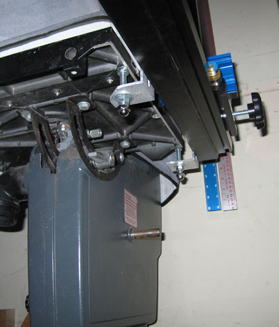

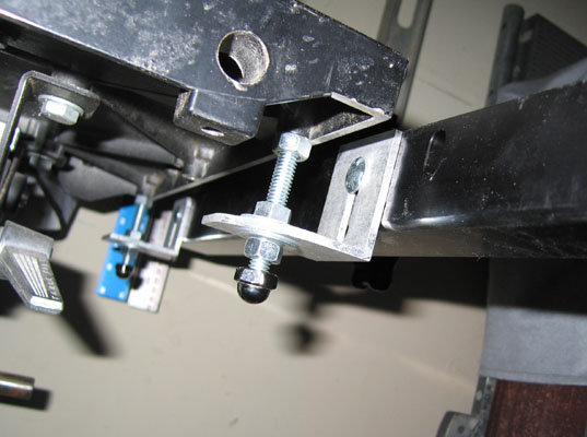

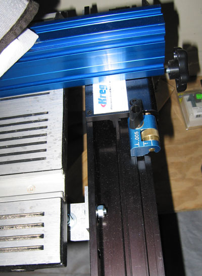

Hey Chris -
The aluminum table does already have tapped holes in the bottom that I used. I will try to take some pics this weekend and post, but basically, I used one at the back and one near the front. Looking at the bandsaw from the front, I put the fence on the right side (so I wouldn't have to take the fence off to change the blade). The angle aluminum is placed as backwards "ells." The fence has vertical mounting holes on the side of the rail, so I used the angle aluminum to make a vertical hole for the fence to mount to. I had to grind the angle aluminum down here and there so it would not interfere with the miter slot or the fence operation.
I say this is angle aluminum, but to be honest, I'm not sure what it is or where it came from. I just was poking around in my "jig part" box and found these ells from some previous project - they may be an unused part from something else. They were already drilled for the most part - I just had to make the hole on the Shopsmith side larger.
I also used some threaded rod to mount it to the table - this gave me the ability to fine-tune the height of the fence by using a couple nuts and washers (kind of like the way the extension tables are adjusted).
I think the Shopsmith version of the Kreg fence will mount on the left, and still let you change the blade. I'm not quite sure how they did that, unless they created some kind of funky cantilevered bracket.

How I Mounted the Kreg...
Here are pics of how I mounted the Kreg bandsaw fence:
[ATTACH]8701[/ATTACH]
[ATTACH]8702[/ATTACH]
[ATTACH]8703[/ATTACH]

Thanks for the pics, I like that system. I ended up drilling and tapping my cast iron table, which worked fairly well, but there wasn't enough material to align the guide block flush with the table. I think I will get the aluminium table retrofit and use L brackets like yours. Thanks for the idea!
