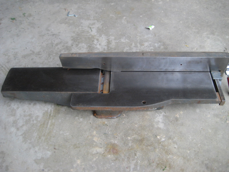

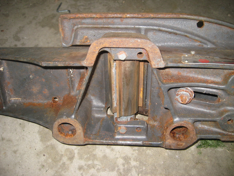

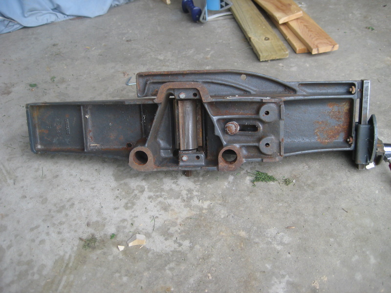

What a difference a day makes!
Before
[ATTACH]8873[/ATTACH]
[ATTACH]8874[/ATTACH]
[ATTACH]8875[/ATTACH]

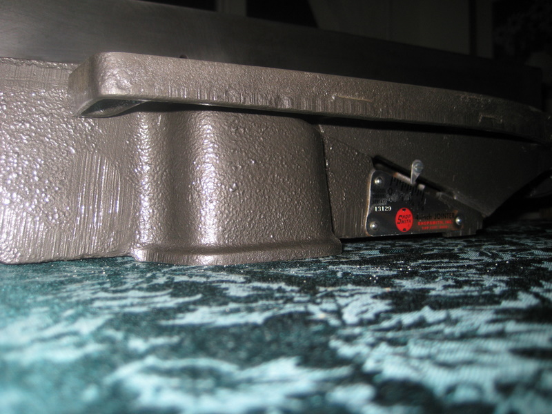

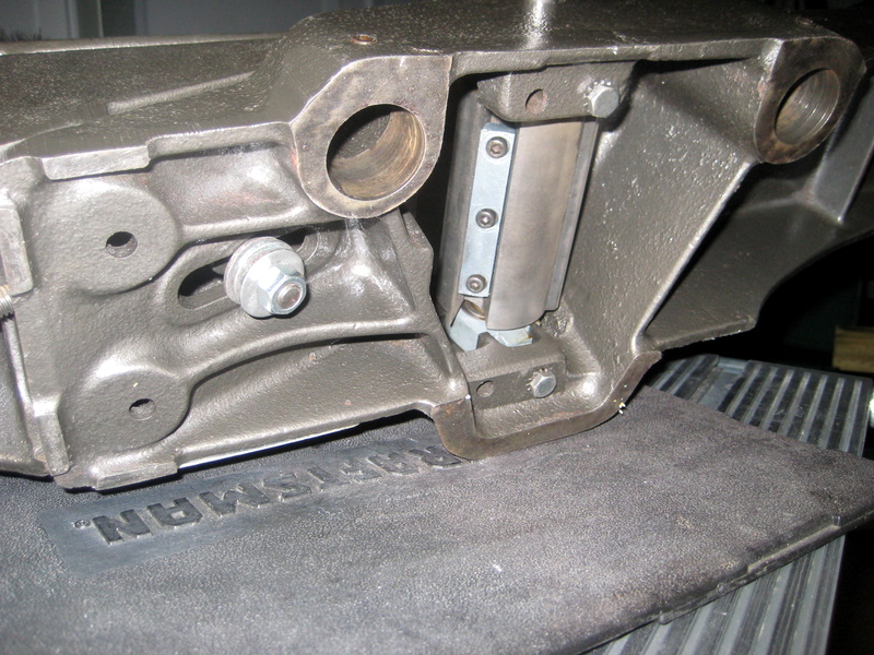

After
[ATTACH]8876[/ATTACH]
[ATTACH]8877[/ATTACH]

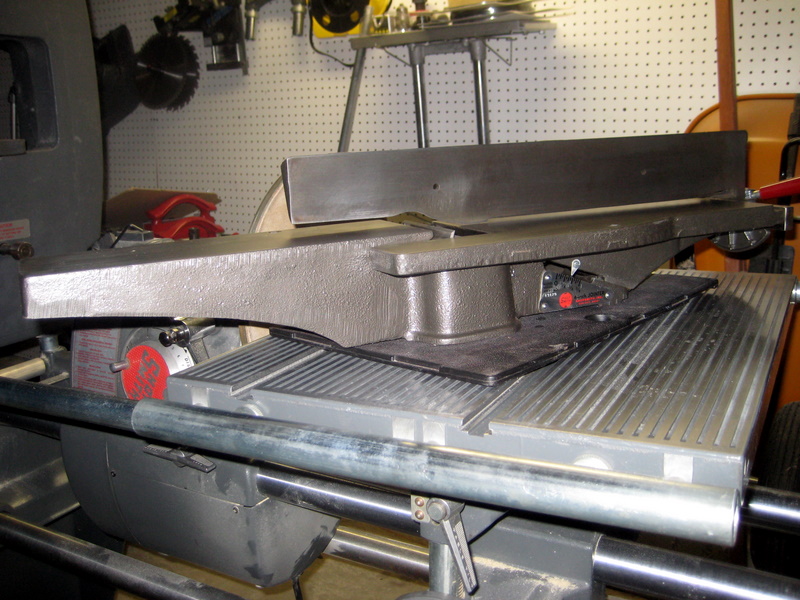

and finally ...
[ATTACH]8878[/ATTACH]
I realized today that I'm also missing the depth adjustment knob.
Overall I still need a blade guard, coupler hub, support tubes, and the depth adjuster knob.

- tom_k/mo
- Posts: 856
- Location: St. Louis, MO
Paul, nice job on the refurb/rehab. What method did you use for the rust removal?
- paulrussell
- Posts: 675
- Joined: Sun Apr 11, 2010 10:35 am
- Location: Dewitt MI
Thank you! I think it actually looks a bit better than the pics because there is zero rust remaining & for some reason it looks otherwise in the pics.tom_k/mo wrote:Paul, nice job on the refurb/rehab. What method did you use for the rust removal?
As for rust removal: I tried the electrolisis method overnight on the upper plate, and although it bubbled, my results were poor. I think my vat was sub-optimal.
Small parts & the fence got a bath in evapo-rust. The unsuccessful table & its brother were given my tried & true rust removal method: a combination of wire brush, steel wool, emery paper, and scotchbrite pads powered by elbow grease and the occasional dremel tool.
A couple particularly nasty nuts were replaced from my junk box. I opted for a dark grey Rustoleum hammered finish. I am MUCH happier with the dark than I was with a silver hammered I tried earlier this year.
To me the dark grey looks better than the original battleship grey, even though the jointer is sorta shaped like a battleship to begin with (and weighs nearly as much),
