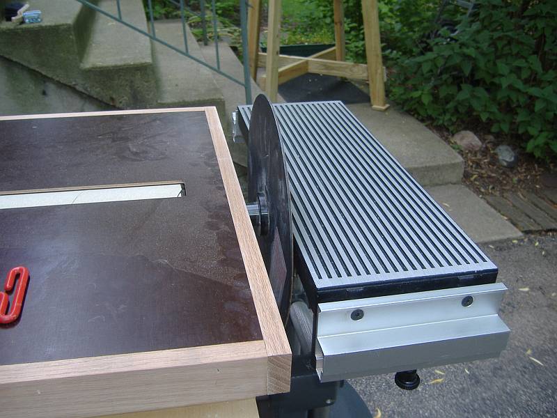

Some of you might be wondering about the usefulness of the PTO so here are a few other things you could do. One would be to mount a drill chuck, universal arbor for a buffing wheel or perhaps a router chuck to hold yet another tool... maybe another sanding item like a fluff sander.

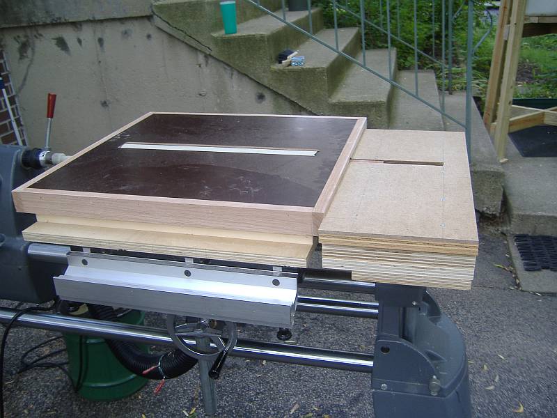

Of course a sanding disk is always an option but you might want to think of adding a extension table to work off of. (Sorry no dust collection attachment, yet).

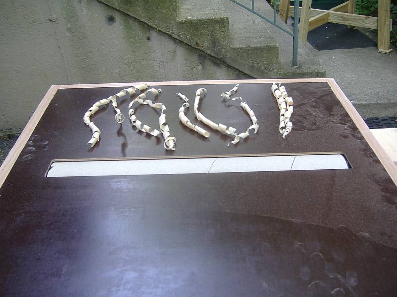

This last one I just had to try. I was to lazy to dig out the 6" drum sander but since I had the 3" one out already.... So here it is the sand-ed driving a sand-free!!!!!!!!!!!!!!!! I just got to stop having so much fun.
[ATTACH]9213[/ATTACH]
Or it could be titled 2007 meets 2010.
