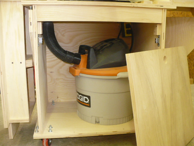

Hi all,
I just completed my new miter saw station and thought others looking to make their sliding miter saw more versatile, mobile, reduce saw dust and etc. I wrestled with what I wanted in a mobile station off and on for a couple of years. I ran across plans for a station in the "Fine WoodWorking Tools and Shops" magazine that fit the bill. The issue is winter 2009. About the only thing I changed was to reduce the cabinet height by 1 in. It has a shop vac installed in the cabinet and locking swivel casters got from Woodcraft. The saw and vac are connected to an outlet that activates the vac when I pull the trigger on my saw. I have a Makita 10" slider mounted on the stand. My shop is only 16 x 24 so space is a little tight.

I studied the plans and thought this through for close to 2 years (I have a real job that takes me out of town a lot) but there is nothing like making the first cuts and moving forward. I really enjoyed the process of bulding the station and have found it to be very functional. In talking about the "arms" the plans called for 2 strap hinges but I didn't think that would be adequate so I used piano hinges. The wings extended with support arms in place are rock solid.
