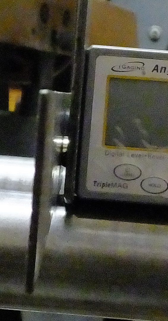

The first pix shows the 'pointer' relative to the 'gauge' used earlier, but was taken just before the following was performed.

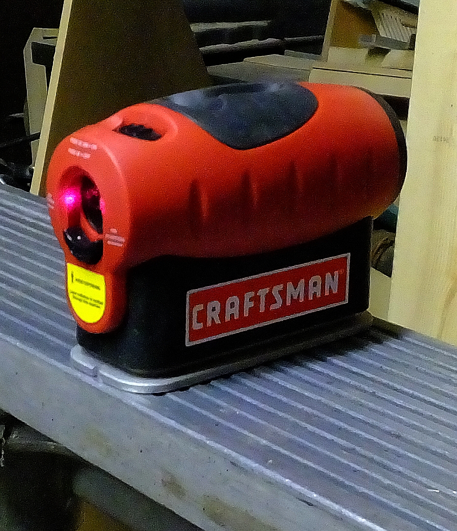

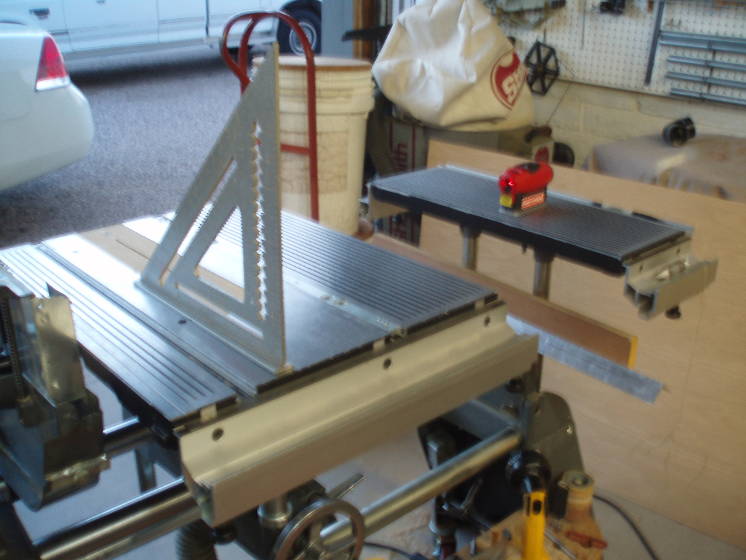

The laser used here was merely placed upon the narrow M5 aux table approximately centered between the aux table mounting posts. No effort was made to position it precisely, but when moved around, little or no effect was observed when moving it.
LASER SOURCE - POSITION.jpg (902.04 KiB) Viewed 2084 times
It was operated in the mode where a horizontal line is projected. That line will be parallel to the aux table top plane(at least the top surface directly under the laser).

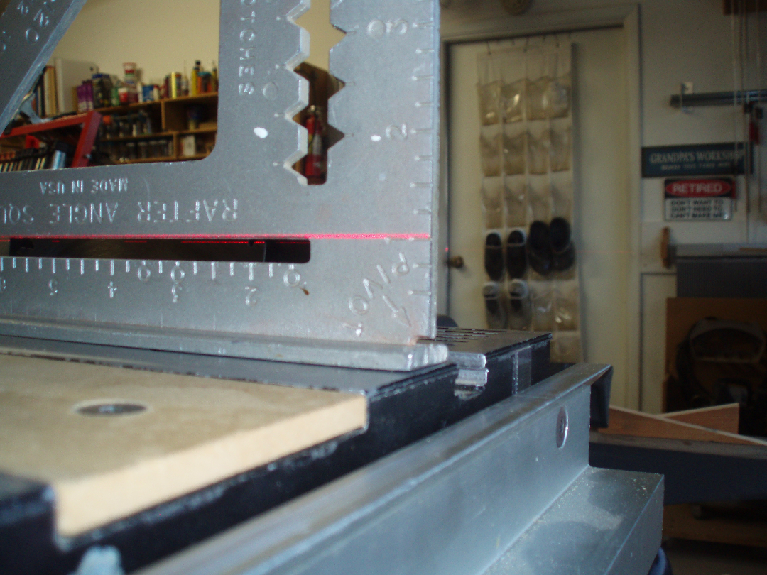

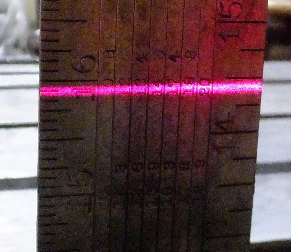

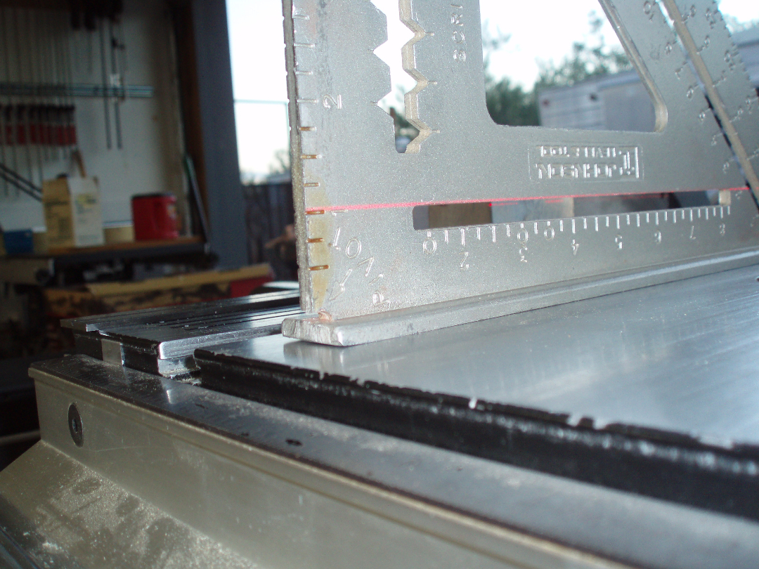

I used two carpenter's framing squares as a method to determine the projected height of the laser beam above the way tubes at the far left end and at a point close to the right end(close to the laser). The tongue of both squares was placed across the way tubes(front to rear) with the body of one over the front way tube and the body of the second square over the rear way tube. The squares were held to each other by magnets and the pair was held vertical by using an i-gauge that has magnets on three of the four sides of the square body. The i-gauge was not turned on, but was merely used as a holding device.

The aux table was moved up to approximately where the projected line crossed the squares at 16" above the way tubes as indicated on the squares. This height is greater than the maximum height of the main table attainable and was chosen arbitrarily.
The projected line is shown in the next two pix.
LEFT FRONT WAY TUBE HEIGHT.jpg (1.08 MiB) Viewed 2084 times
LEFT REAR WAY TUBE HEIGHT.jpg (882.66 KiB) Viewed 2084 times

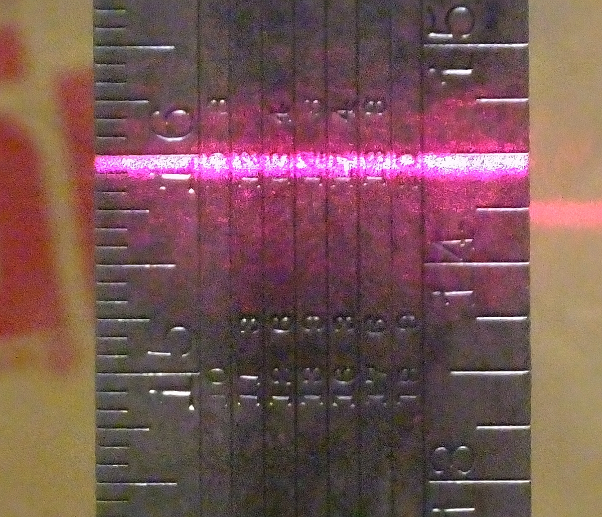

Notice the rear is less than 1/32" lower than the front. That represents less than a 0.2 degree tilt downwards towards the rear.

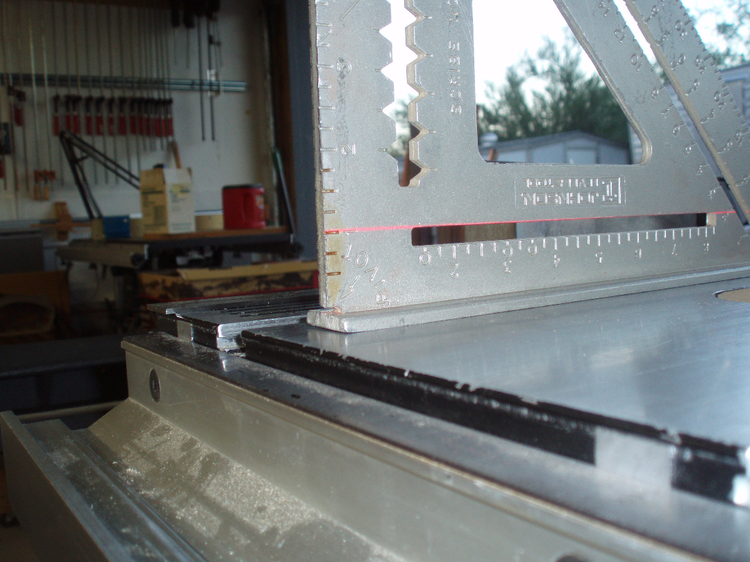

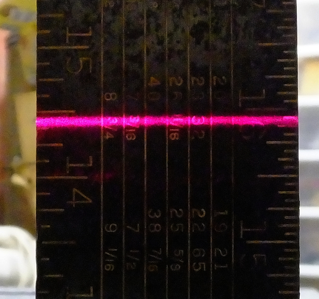

So now the squares were moved close to the right end.
RIGHT FRONT WAY TUBE HEIGHT.jpg (984.76 KiB) Viewed 2084 times
RIGHT REAR WAY TUBE HEIGHT.jpg (751.12 KiB) Viewed 2084 times

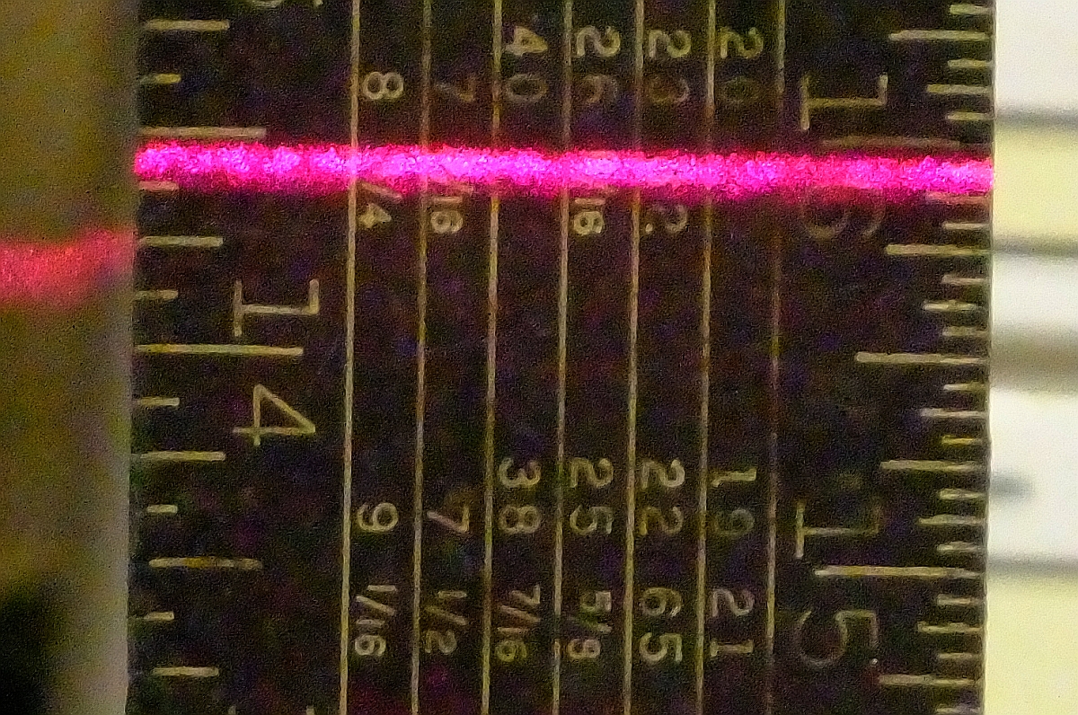

Both front and rear are about 1/32" lower than at the left end. That amounts to about .034 degrees. ( a word of caution re the scale on the front square. It is calibrated in 1/12", not 1/16")
Now we still do not know the situation with the aux table, but that has to wait until after the main table is aligned. Then the aux table can be adjusted to it. Keep in mind the laser is not moved throughout this entire procedure so the front/rear difference observed may be due to slight aux table tilt downwards towards the rear.
However since the front/rear deviation is the same at both the close and far end, we can conclude that it is indeed the table that is tilted, and not the way tubes being twisted. That confirms the correctness of the previous set screw adjustment.
Furthermore since the beam is lower at the right position than at the left end, we can conclude the aux table is slightly tilted with the inside edge higher than the outside edge. Again the difference is about 1/32" and indicates an error angle of about 0.034 degrees which results in the left side of the table being about 0.002" lower than at the right side.

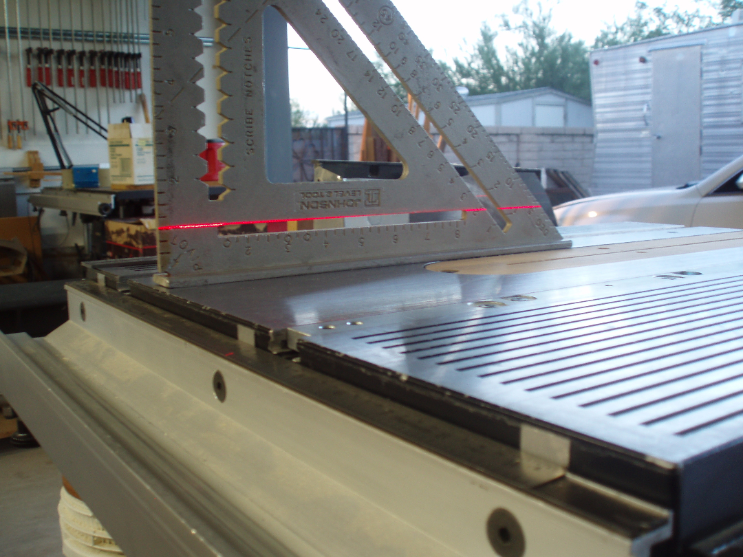

Here is a slightly different approach at using a laser. With some refinement and some real serious thought about "calibration and procedures", this could be very useful.
You are to be commended JPG. As an engineering technician, I seldom said that about or to any engineer I worked with.
Should have used a tripod.
Laser Preparation 004.JPG (1.07 MiB) Viewed 2028 times
Laser Preparation 005.JPG (1.05 MiB) Viewed 2028 times
Laser Preparation 008.JPG (1.09 MiB) Viewed 2028 times
Laser Preparation 009.JPG (1.12 MiB) Viewed 2028 times
Laser Preparation 010.JPG (1.14 MiB) Viewed 2028 times
