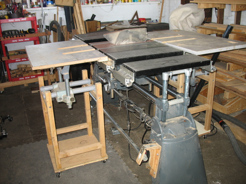

Here is my "solution" for an outfeed table. It is not where as pretty as Dusty's. :o I needed something to use with the planer, and that requires the out feed table to move up and down. I could never get other designs to work well enough to use. After I made the decision to use an old SS table, I re-purposed a wood stand I salvaged from a school science lab remodel. This arrangement was a bit short for the table saw out feed. I added the slotted legs to raise the whole thing enough to allow the table saw to be used at full height and lowered for the planer.
I can't claim any new idea here, it is based on a comment someone made on the forum that the best out feed table for a SS is another SS. I have never found one I wanted, nor do I really have room for one. It is not as easy to use as I would like, but it is functional and serves both saw and planer. I am going to try it on the jointer as well. With the fence in place, it works fairly well with the table tilted. I will probably get some more finger friendly nuts for the bolts at the bottom, I will clean up the table and paint the rest of the wood. There is some space for some small storage under the table, I may put that in later. Total coast was $45 for the SS table I think.
Dave
Fantastic, Dave.
If your re-purpose table had just been a little taller, you could have taken advantage of the carriage height adjustment so much easier.
However, we are not the only ones with re-purposed hardware. This was done by another forum member (Doc). I have not see a post from him in a long time.
[ATTACH]11431[/ATTACH]
