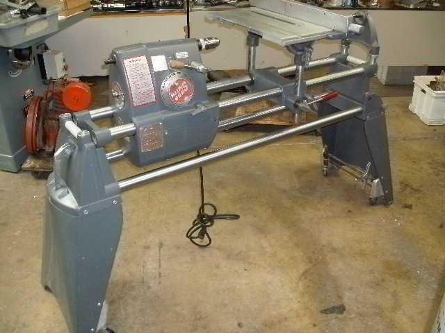

The SS Mk 5's (two tone green paint and two tone brown paint) and
SS Mk V 500 have the smaller table and the table riser is a lever.
[ATTACH]18320[/ATTACH]

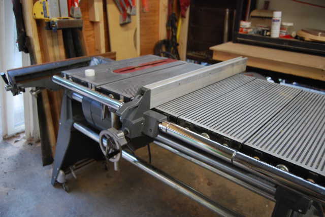

The SS Mk V 505 and 510 have the larger table and the table riser is a
crank. The fence rails are tubular and it includes floating tables.
[ATTACH]18319[/ATTACH]

[quote="rpd"]The difference between the different models is in the tables and rails not in the headstock so the serial number is not a help in identification.
Thanks all for the help so far, this one looks most like mine. I was looking a little more at it today in between jobs. The lower saw gaurd is plastic if that helps more. Mine does have a lever for the table as well This thing looks like its seen little use. Over the weekend I hope to get more pictures of it and post.
