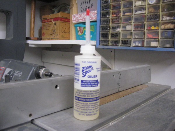

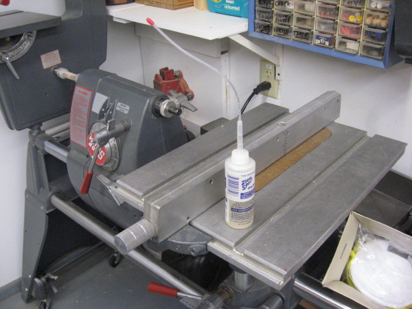

oldc6
Posts: 233
Joined: Mon Feb 11, 2008 9:22 pm
Location: central minnesota
picture of zoom spout oiler
Post by oldc6 »
What Bill Mayo is talking about. works very slick. get at ACE hdwe.[ATTACH]18718[/ATTACH]
[ATTACH]18719[/ATTACH]
