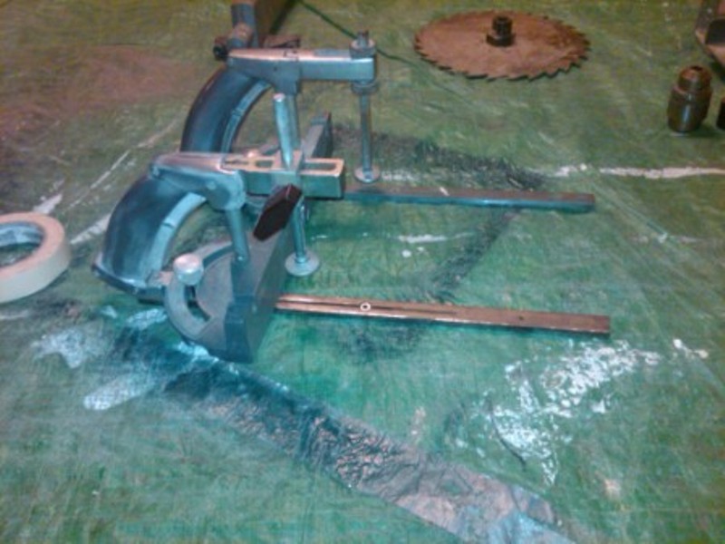

Here are photos:
First is of the miter gauge in question. In the background is my 1955 for reference.

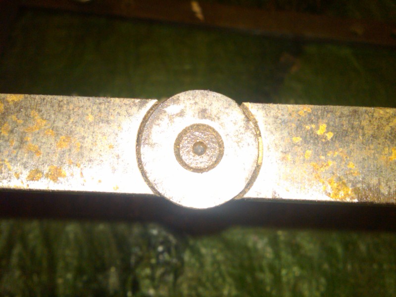

Here is the bottom of the washer.
[ATTACH]23400[/ATTACH]

beeg
Posts: 4790
Location: St. Louis,Mo.
Post by beeg »
LOOKS like the allen hole is rounded out.

Post by ipbarnard »
Update!
I had to set up my MK V as a drill press and drill it out.
I had hopped there was an easier way but some times that is all you can do.
